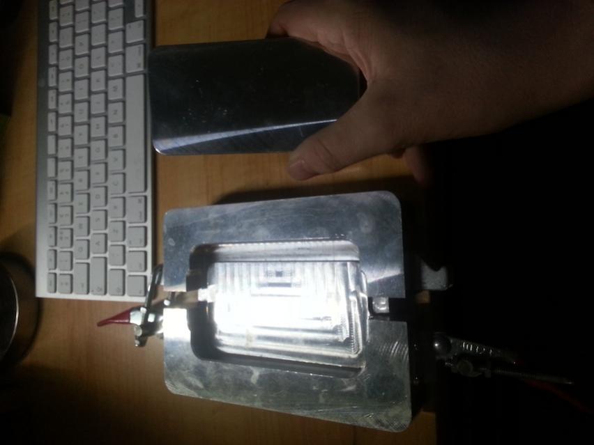

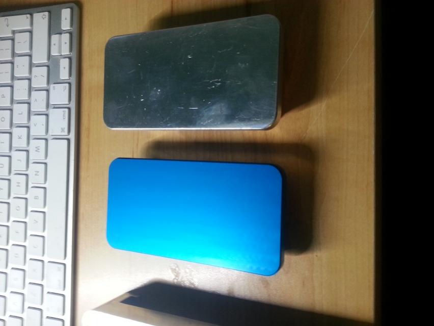

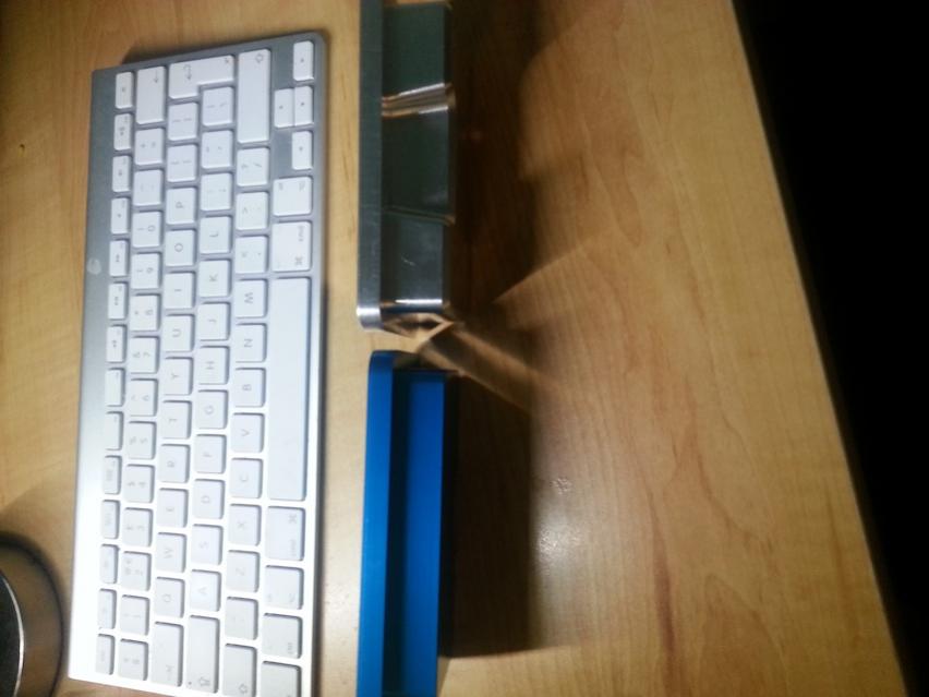

We usually keep them on the puck, and then depending if its a matt finished case we air cool, or for a gloss finished case we use the metal clamp system to stop them deforming in the water (you can use cover on the puck and lowering into water too which gives the same result, but we like the clamp as can drop and move on to the next without damage to the gloss surface). We have tried using the cooling air jigs and found them not to be as good as just leaving the case of the puck.
ipad/mini I would also leave on the puck to cool down, always worth buying more pucks. I've enclosed to picks showing the clamp system and the main two kinds of pucks the blue one has a much lower profile and makes for taping better, but the silver one conducts heat better and give a better print on the sides.
