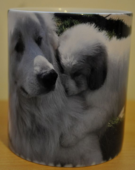

Hmmm did they end up looking like this at the bottom ??

I get that sometimes with poor transfer paper contact. The funny thing is my customers think I have designed it to do that and are impressed by the effort I have put in to achieve that effect lolRenniwano;51480 wrote:Hmmm did they end up looking like this at the bottom ??

Try that same mug again with a 5mm gap at the top and bottom....personally I think that looks better as it borders the print in keeping with the gaps next to the handle

Personally I like the border.. but what about when a customer wants a full wrap.. and you can't offer that because of what happens above ??

Is the mug press nice and tight so you can see the blanket curl over the edge of the mug? You do need exceptionally good mugs to print full wrap, I try and avoid it but do the odd one. Even leaving a very small border of a couple of mm makes all the difference. Also, do you cut the transfer to fit or allow a bit of an overhang?

I am kind of hijacking the OP now.. sorry.. but likewise I use wraps and an oven.. and wondered whether they could be the issue at all..
My paper is cut to size no overhang (should there be ?? lol).. clamps are tight to the point I sometimes struggle getting them undone whilst hot..
Other than full prints (which the mug above is the ONLY one I have ever tried.. and never retried) everything else comes out perfect
