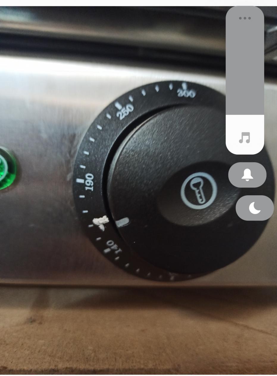

Received my BC01 yesterday and have just set it up.. have a few mugs in there now at 200 degrees [emoji1695]
As for the manual… [emoji533][emoji51]Image
Re: Has anyone had luck with the BlueWave 5 in 1 Mug Press? I haven't...
[ATTACH=CONFIG]7288[/ATTACH]
20 minutes.

What does your thermometer say at that setting? Mines way higher [emoji28] did a gun test on a mug and it said 200 degrees, granted I didn’t check if the preheat light was off 🫣
Never checked it. I warm it to that temp and stick the mugs in, perfect consistency every time.
