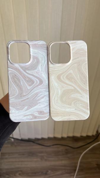

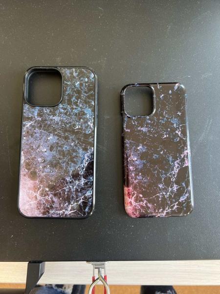

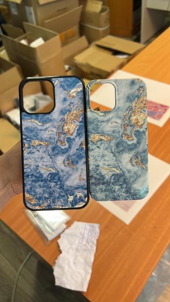

I am using ICC profile that my supplier gave me but this profile do not help me to get good result even worst colors than if i only use as an ICC epson l1800 series photo glossy and choose in the settings paper type photo paper glossy but its still not good result. I also attach photos on the left how it should be as i am making 2d cases with sublimation paper for couple years and on the right how i get with sublimation film and sublimation machine on 3d case. What settings should i choose?

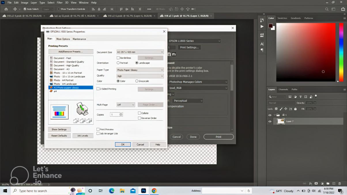

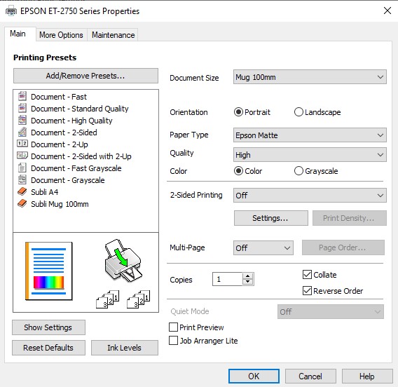

[ATTACH=CONFIG]6967[/ATTACH]
Show me this screen and also the other tabs.
vB_ID:6967
vB_ID:6967

Can you see it?
vB_ID:6968
vB_ID:6968
Screenshot (3)_photos_v2_x2_colored_toned_light_ai.jpg (99.38 KiB) Viewed 640 times
Posts: 12115
Has thanked: 13 times
Been thanked: 12 times
Re: Epson l1800 printing on sublimation film problem
Yes, you're on glossy which is incorrect. Other tabs?

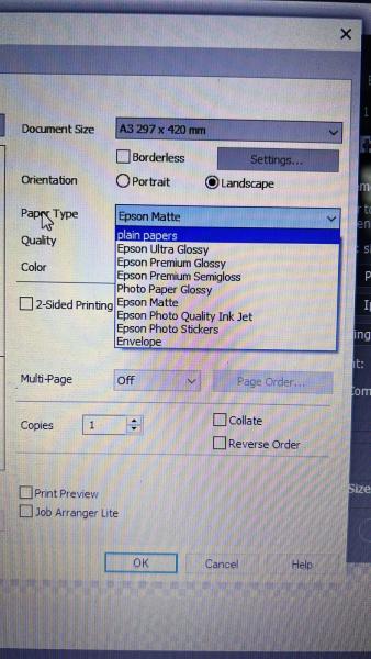

Attach other tabs options
vB_ID:6969
vB_ID:6969
WhatsApp Image 2022-07-12 at 10.55.36 AM.jpg (38.77 KiB) Viewed 640 times
Posts: 12115

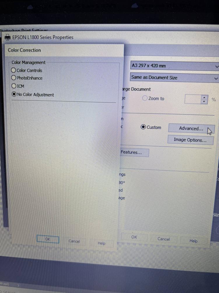

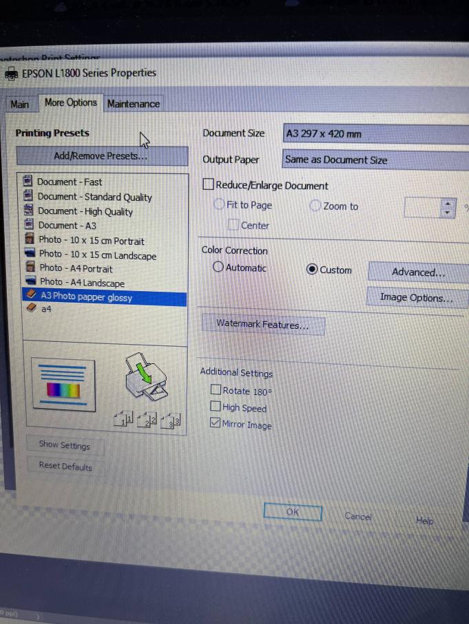

These two tabs?
[ATTACH=CONFIG]6970[/ATTACH] [ATTACH=CONFIG]6971[/ATTACH]
vB_ID:6971
vB_ID:6971
vB_ID:6970
vB_ID:6970

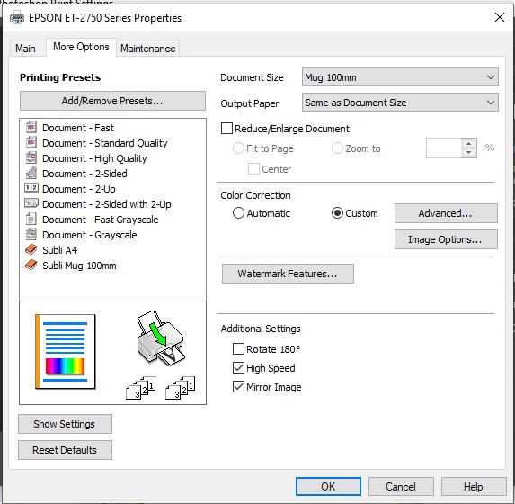

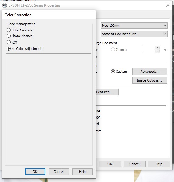

attach photos
vB_ID:6974
vB_ID:6974
vB_ID:6975
vB_ID:6975
