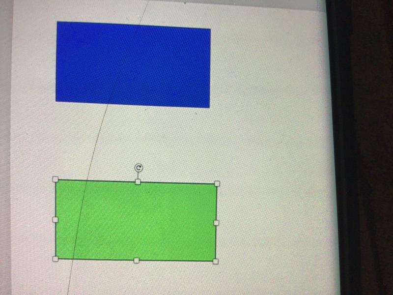

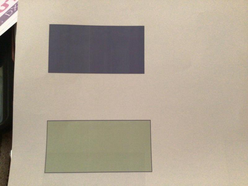

Update - I set up the printer on my MacBook and the colours are printing although not as they are on screen (see photos)[ATTACH=CONFIG]6424[/ATTACH][ATTACH=CONFIG]6425[/ATTACH]
I presume this is because I don’t have it set up as using sub links or have the ICC installed?

Re: Colour issues
Yes, you need an ICC profile from your inks supplier to achieve anything near the expected colours.
Once you've installed the profile, allow Photoshop to manage colours and select the profile from the drop-down list. Make sure you turn colour management OFF in your printer settings.
A couple of things to note -
1. The printed colours will not exactly match the colours on your monitor (unless to buy colour calibration equipment to calibrate your monitor).
2. The printed colours will look off-colour and dull on the paper but will look totally different when pressed, so you need to press an item to see the final colours.
A good idea is to press a colour swatch and then you will have a good reference as to how your monitor colours translate to actual colours on the final printed and pressed product.
