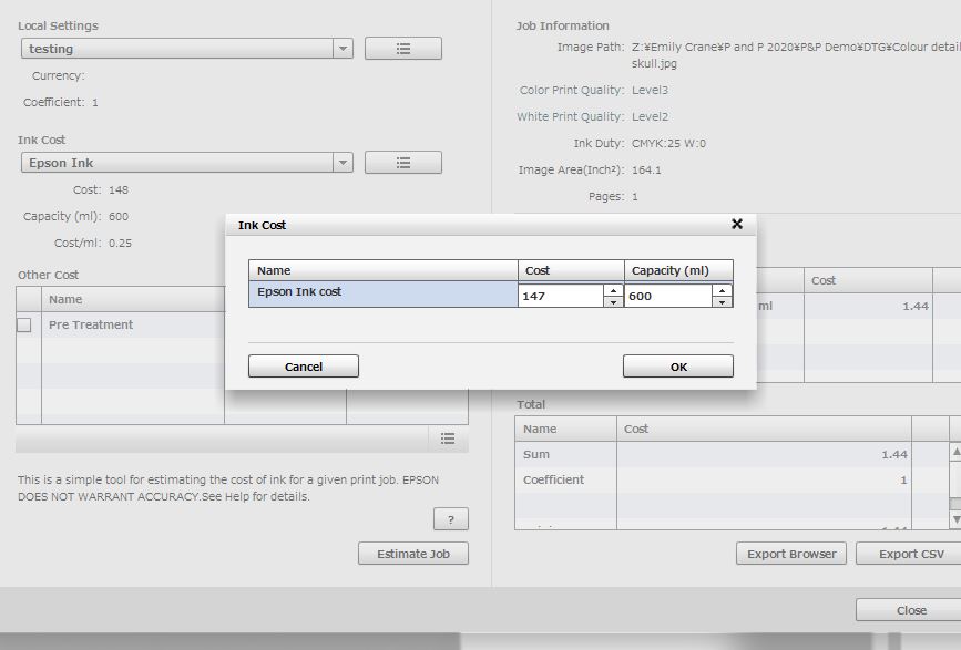

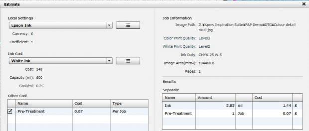

Garment creator has cost calculator built in, I have attached the calculation from the Skull print. This estimates the cost based on the setting that you have used to print the job, you can even add t-shirt and labour costs.
Given what Andrew said earlier, do we need to double your figures to get an accurate idea of costs ?
Like all printers (solvent and dye sub) the Epson will use ink in cleans. If you only print one shirt per week then yes the cost per shirt is going to be more due to the ink that has been used in the cleaning cycles. If you are using the machine daily then it will do less cleaning and the cost calculator will be more accurate.
If you only plan to print the occasional t-shirt then i would question if DTG is right process for your business.

Ricky, does that show just the cost of the white ink .... looks like you can select colours in the drop down?
http://www.logobear.co.uk/

Hi Logobear
The calculation is for all inks not just the white.
When you set up the ink cost calculator you can add what ever name you like, for some reason someone named the preset white ink on our RIP. As you can see from the attached screen shot this is easily changed.
Ricky
