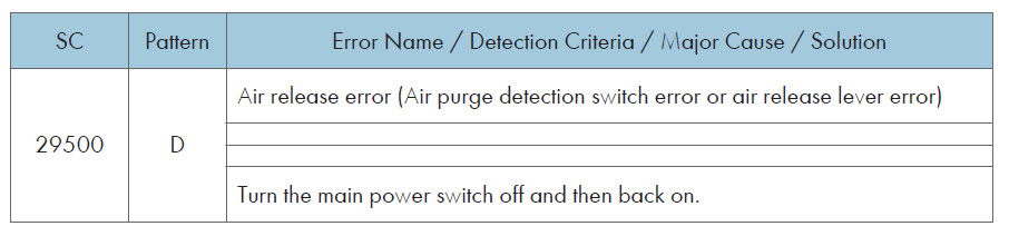

I live in Berlin. That's very nice, thank you. That's what you said that sc29500 "there is an air trip error (error at the vent detection switch or error at the air outlet lever)" hot. I should know where these switches or levers fit so that I can test. The printhead I once removed vent hose is free but in the environment no switch or lever seen.
Re: Does anyone know what error code 29500 means ..?
This is the error code explanation from the Service Manual ...
vB_ID:5533
vB_ID:5533
Exactly as Earl posted previously.

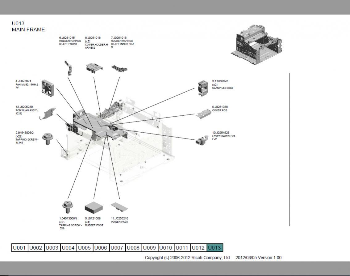

I can't find anything in the Parts Catalogue relating to 'air purge' or 'air release.' Maybe it refers to the minute bubbles in the ink when head cleaning and recommends you turn off fror a while to let the bubbles settle. Or maybe it's overheating due to the right-hand side vent being blocked.

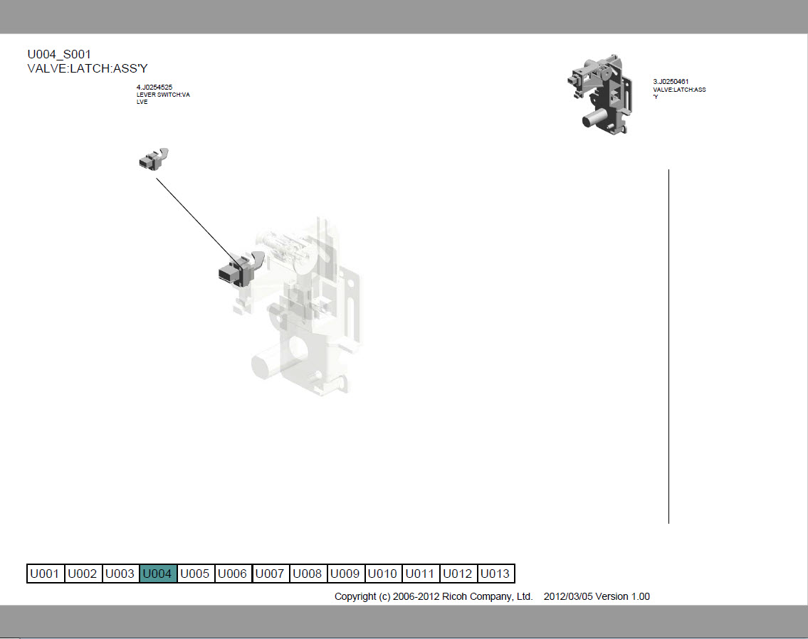

The only reference I can find to a 'lever' or a 'valve' of any description is the part J0254525 as seen in these two diagrams, but don't know whether that has anything to do with it.
vB_ID:5535
vB_ID:5535
vB_ID:5535
vB_ID:5535
vB_ID:5534

webtrekker, thank you very much. Jo254525 unfortunately upper cover switch. It should be somewhere near the printhead I think .. Nevertheless, I appreciate your efforts. Thank you so much.

Post by tagoz »
Webtrekker I thank you a lot, problem was switch J0254525 .. Although it is exactly the same switch as the top cover lid but of the switch even a seat behind the print head when the stand was in peace and to the switch hangs a lever to operate the switch. Lever had slipped out .. I have locked the lever, error is gone .. Now I have error code sc 28111 :-) , this is a printer. Although I have no guarantee but actually unpacked completely new.
