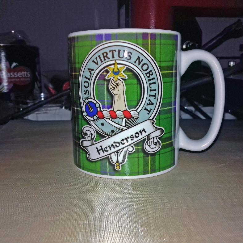

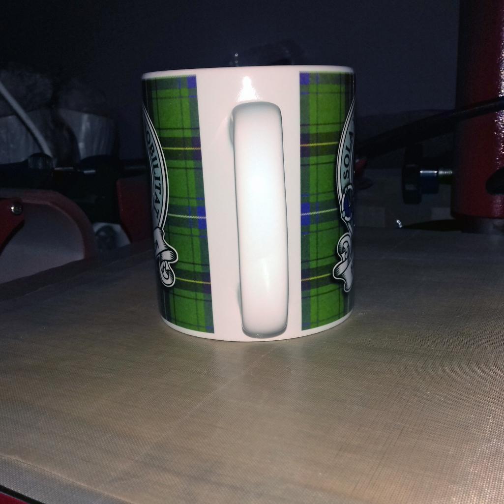

Here's an example of what I'm getting with the wrap the height of the mug, almost to the handle at both sides, and no cover except the silicone wrap. Cooking temp 180° C ~ 200° C for 9 minutes (once oven has reached temp)...

This was taken a while back when I was using LW 10oz mugs.

smiley_mug;135063 wrote:thanks for your help, cutting the paper to shape looks like a real faff
No faffing around cutting to shape - I just cut the paper longer and break it over the handles so that it pretty much covers everything.

yes i see what you mean when i first looked I thought it was all perfectly cut to shape. Thanks for posting the pic, its good to know I'm not alone with this problem. I've just made a paper rectangle bridge for now so the tape doesn't touch the mug and it has fixed it although it doesn't hold the sub sheet in place like direct tape did. Once Ive used up my preprinted sublimation sheets I'll try printing 2 a page and use your method :)
