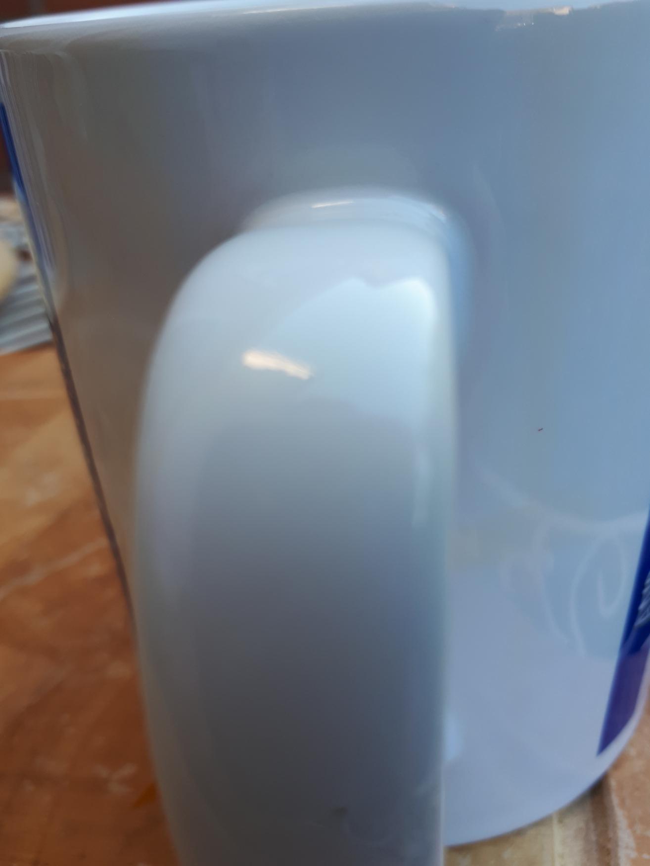

i'm printing mugs in halogen oven and I'm liking the print quality especially near the handles but I've noticed I'm getting yellow marks where the heat transfer paper sits and a vertical stripe where the edge of the paper lies. I'm using the sub paper plus a couple of sheets of copier paper to protect the wrap. Has anyone had similar and know how to prevent.

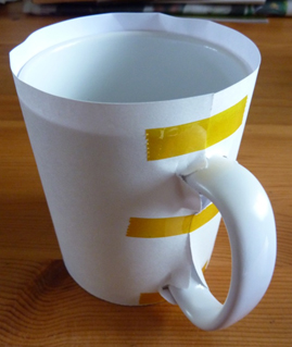

I used to have this problem - I think it's just rogue ink gas in the oven. Solved it by cutting the paper slightly longer and 'breaking' it over the handles as shown below so the full mug is covered. I also find I have to let the paper go a bit yellow with heat to get full transfer without any faded patches. Not a problem unless it goes really brown!
