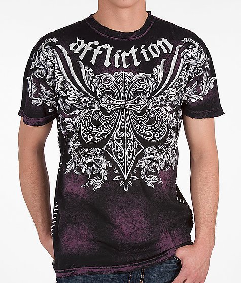

Now this is where it gets tricky - we have the design, and I'm not going to post it - but I'll post something very very similar in terms of shirt real estate so you catch our dilemma - the design covers, in a continuous and fluid motion, not only the chest but the shoulders and sleeves and rib area in a large spread across the seams.
Now I've taken the order - learned in business a long time ago when the big cash is dangling, you say no problem and get it signed - figure the rest out later. Worst case scenario, we chop right into the profit margin and outsource - but I'm not ready to give up yet.
Just before we part with the money for the Printer Cutter, I'm now reconsidering using the money for a DTG with a large enough box to cover this.
I'm hoping you guys can jump in here and tell me if that sort of design is do-able in a DTG or if it would be screen only - something we're not looking to get involved in doing, so would need to outsource.

Hi. Congrates on the order.
With my limited knowledge of DTG Id say that it is too large a design to print. Unless your looking at a Kornit or maybe the large Brother machines. Mucho money needed.
For that quantity Id say to look at getting a Screen print setup. Much much cheaper. The cost per print would be minimal , cents for each print.
THe real problem with screen print is the space you will need to set it up. You will also need a dark room and a wet room for washing the screens. Dont use your bathroom, the wife will kill you. The printer could be a one arm, one colour setup so you wont need too much space.
Or you could have transfers made. Again the quantity is to your advantage for a good price. The only problem would be the need for a very large heat press.
Good luck. Im sure there are more knowledgable peeps on here who will have ideas too.

Do they have to be cotton t shirts? How about getting them made as a whole item? Find a manufacturer with a wide format textile printer and get them to make the tshirts. I am sure at that large volume there should be enough wiggle room for you all to make a bit of money.

Zoti Sports http://www.zotisports.com/ may be an option?

I would have thought for 5000 off that screen print would be the best way ?

No doubt about that! 5000 on a DTG - impossible.
