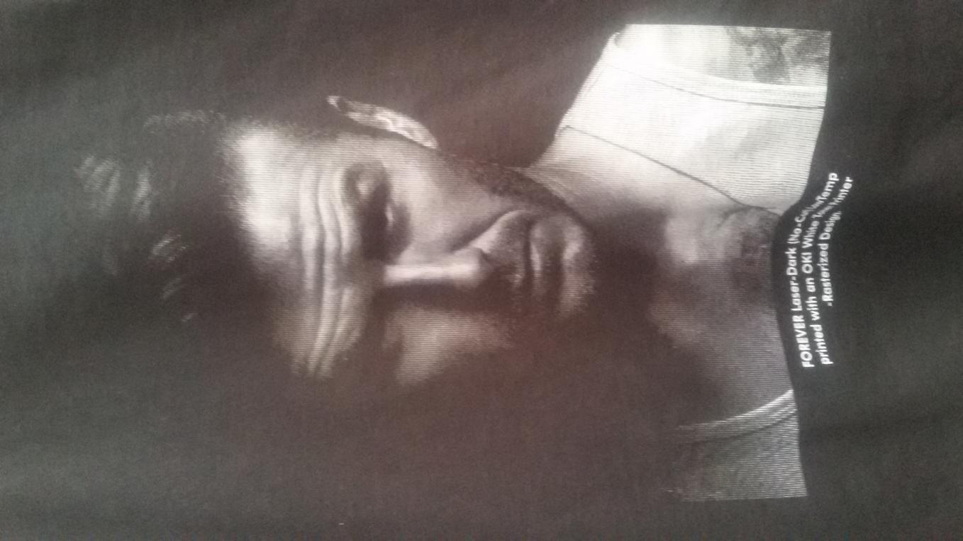

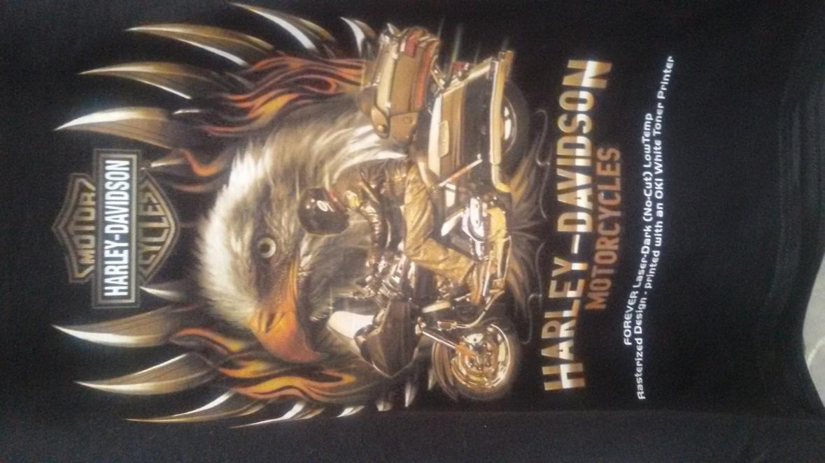

Sorry, not very good photos but I think you get the idea.
- vB_ID:4539
- 20170322_122046.jpg (95.74 KiB) Viewed 673 times
- vB_ID:4538
- 20170322_122013.jpg (95.22 KiB) Viewed 673 times
