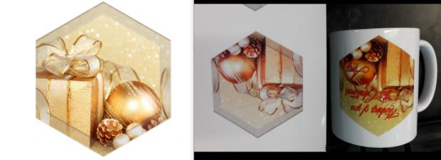

The picture below shows two t-shirts I printed earlier this week. The one on the right is using City Inks profile, the blues are purple, the reds are orange the yellow is too dull and the grey is sepia. The one on the left using 1500 standard has bright blues, reds and yellow, and the grey is about right. The colours from the Epson profile are pretty much spot on.

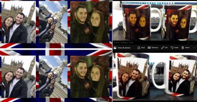

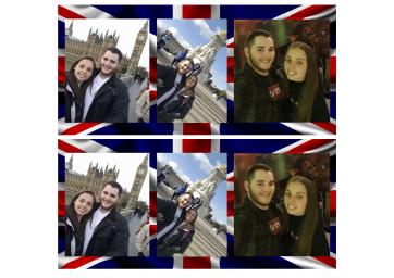

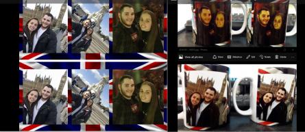

Hi Everyone,
Just seen this post, and how new it was and I am having similar issues with a new EPSON 1500W with City Ink Express on TruePix Paper.
I chose the Epson 1500w for sublimation as I already have one that prints photos and banners with "Normal Ink" and it has been a workhouse with excellent quality compared to the screen image this is so good that is the reason i went with the same machine.
We have set up and gone through the process 3 times with a fine tooth comb on the instructions to make sure we were getting it right, with the same results (isnt it the case of something about insanity being repeating the same thing expecting differing results)
This image below is showing LEFT - screen shot from Photoshop - MIDDLE - camera shot of photo from EPSON 1500W RIGHT Sublimation on MUG from new Epson 1500W
Firstly the MIDDLE Camera shot isnt brilliant it looks pretty much the same as the screenshot to the normal eye - the camera has distorted this.
However, you can see the massive difference in contrast and colouring to the Mug Sublimation.
Then there is this picture below again showing the Photoshop screen capture on the left, and then the mugs on the right ... The top mug with the ICC provided and the Bottom Mug, with a slight tweak on Printer settings
I understand there will maybe fine tuning from an ICC, but this just looks drastically out!
I have printed the mugs with 180 for 180s, 170 for 150s and 180 for 120s and this does not alter the outcome.
It just looks like the contrast and colouring are up way too much.
Any thoughts on directions from here. I am already liaising with Paul to get another ICC but am I missing something .... shouldnt an ICC be accurate!
Kind regards.
Stuart
