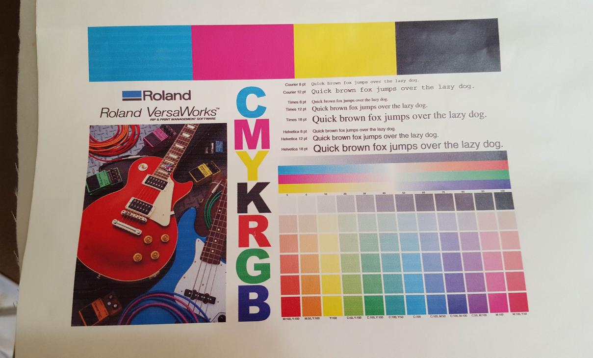

HI guys managed to get a test print today ..Not so sure this is good or bad ..I can see some banding on Cyan (May be due to few blocked nozzles )and print quality is not solid as my normal printers .Is this test print look okay ??... Thanks

How long has it been sitting with no ink? Run a power clean to see if it clears the banding.... do a test print via the panel and drop a picture here :)
That test print wont show much ... this is mine when I bought the VP...look ok yea!
But you can see here, at least one head is shot

Scotty thanks for the update... I had no ink on it when bought it as the guy took them off ..orderd new ones and took a day to receive and I only done a simple clean and the tear print ...I'll do a power clean and update ..thanks again for the WS link u gave me..I had no clue otherwise..
