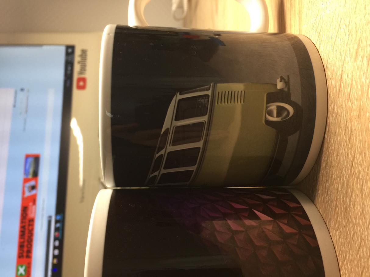

Place 2 mugs on a flat surface an push them together. You will be able to see light through any gaps where the mugs aren't touching. You need smooth, parallel-sided mugs for best printing results with no tapers, dents, barreling, pincushioning etc.
Re: Tips for Getting images Staight??
Can you look on the picture if my mugs are within the tolerances? What i noticed is that one mug is larger. A much bigger problem i have now is that i can not use the mug press anymore, it produced chemical gases even when a blank mug is in it.webtrekker;142078 wrote:Place 2 mugs on a flat surface an push them together. You will be able to see light through any gaps where the mugs aren't touching. You need smooth, parallel-sided mugs for best printing results with no tapers, dents, barreling, pincushioning etc.
