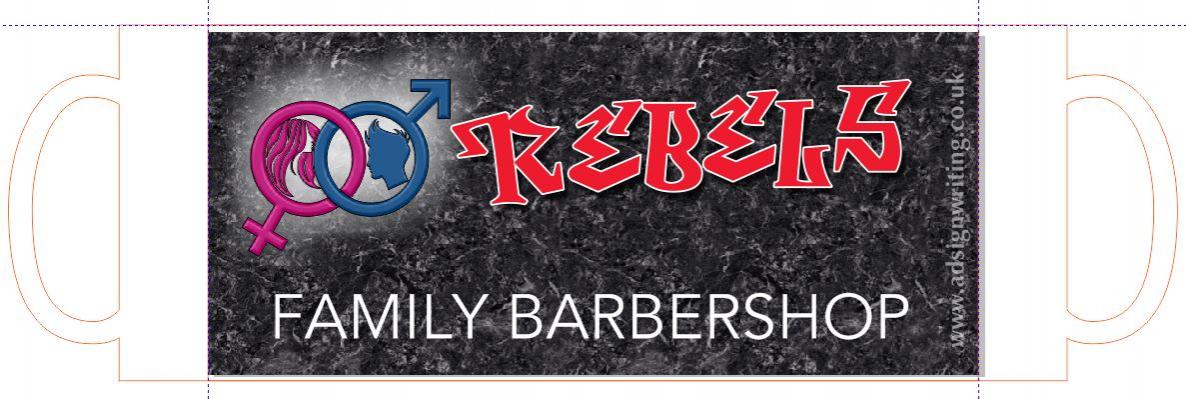

I use the same method as Janners, custom page size in the Power driver (once you've made one and saved it), select landscape in the Powerdriver. Paper goes in printer portrait/short edge first, print side down. I also Corel Draw and you can select landscape from there but I find it just as convenient to do it in the Powerdriver. I've also made a template in Draw which has a page size of 195mm X 86mm and shows a mug outline on another layer which I can make printable or not depending if for output or customer approval
