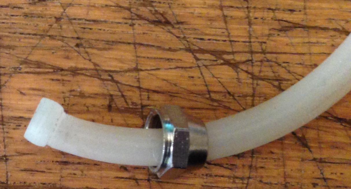

Looking for a tube that is as the attached (both ends) for my 3D heat press. BMS thought they had one but the ends are cut off rendering the tube no good.

Simon, have you still got the metal end bolt? I thought the tube would slide on with some persuasion!

Yes, I still have the nuts, the tube slides over the fixed bolt and then I can screw it down, but the problem is that it slowly works it way off. I am getting by for now, but ideally I would like to get a complete set of hoses just in case.

Is this for a 3042? My hoses haven't got the flared bit on and doesn't screw on either. Just pushes on and doesn't work it's way off

Not had issues before either once the bolt is screwed on. Maybe try another tube?

The hoses don't come with that dimple on the end though, that's created by pushing it on to the nozzle and then the nut being tightened. I'd recommend changing your hose, though. I stopped using those hoses as I was sick of them cracking and breaking exactly like you said. I now use a length of this hose:
http://www.autosiliconehoses.com/3mm-si ... black.html
You can't get the metal nut on as the hose itself is the same width as the hole in the nut, but I've been using mine for months with no nut at all (it's tight enough to just push on to the nozzle) and it's the longest I've ever had a piece of hose without having to trim it from it cracking or becoming loose.

Yeah, I figured that out... in the end
All good, just me being stupid!

I think you'll find that the bulge on the end of the hose is actually made that way. Nuts are put on the pipe and then the end is swaged into that shape. It acts like olive on the end of the pipe.
