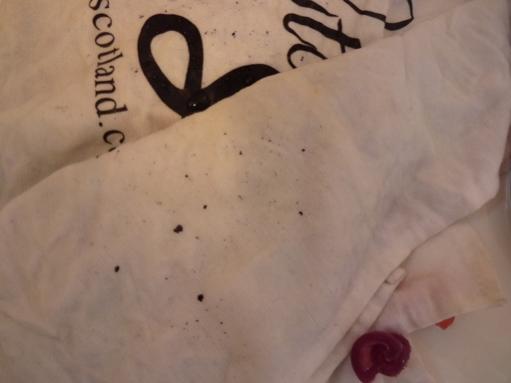

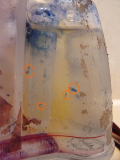

Hey Gooner,
Funny you mention this, I was having blockage headaches and decided to flush the Ciss tanks out and buy new Ciss system. While doing so I took a couple of photos. A towel covered in congealed ink drops and the other photo is the ink tank where i have circled large blobs. The worst of it all went down the drain before i decided to take photos.
I'ts no wonder I had so many issues.
the inks where in date but shows that Storing your ink is very important - lesson learned

Thanks for the photos. Were you getting good nozzle checks or was it obvious there were major problems? I'm trying to figure if my banding is caused by dried up ink in the print head, bad ink or duff Epson printers.
I'm getting perfect nozzle checks, but banding in the reds, so not sure whether I should be using my old ink in the new printer due to arrive. Trying not to spend hundreds on new ink!
