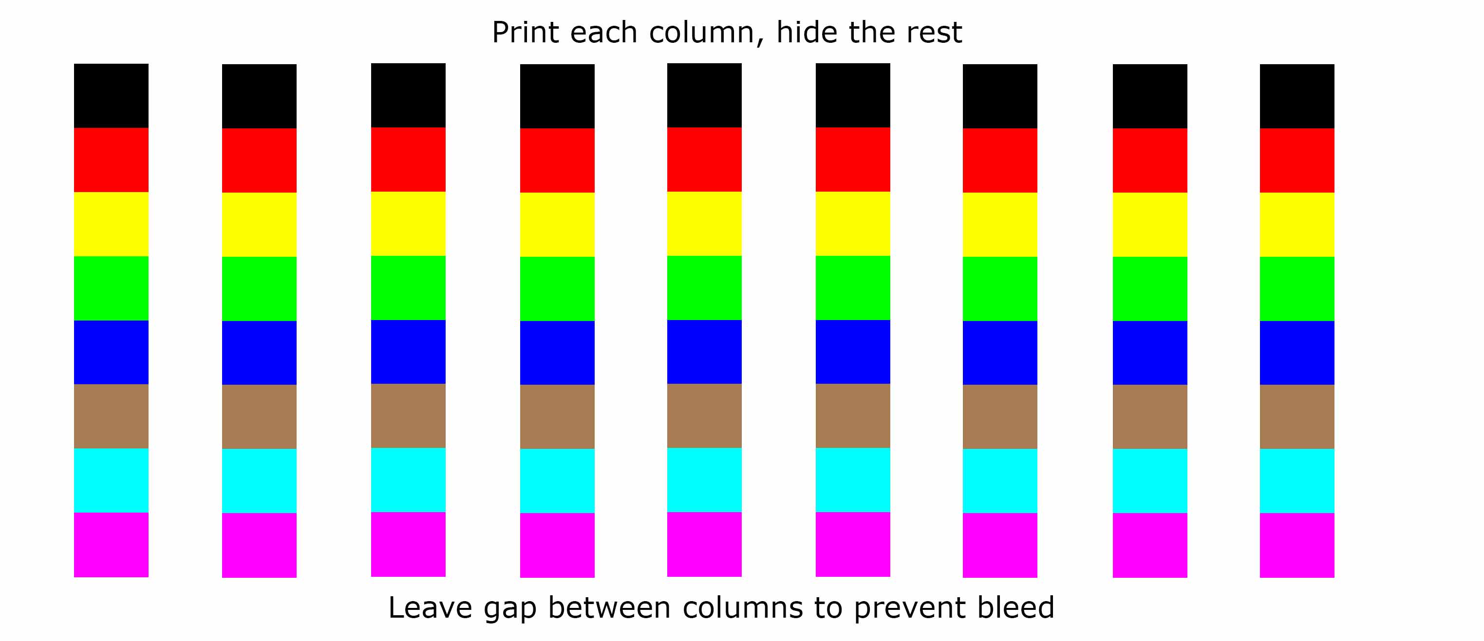

I don't have a 3d system but it would be worth sacrificing a few mugs by over cooking by a few minutes each time. Not tried this but you could create a template divided into small vertical strips containing a colour bar, print a sheet with one bar only, cook, print a sheet with the next bar only, cook etc. That way you use one mug several times and end up with a chart of cooking times.
I would use a new sheet of paper for each print to prevent any ink that may be on the element from transferring to the mug. I am also assuming that the mug can be printed multiple times.
Pre heating the mugs may be in order for multiples as there is more mass to heat which affects cooking times.
This technique would lend itself to testing a variety of substrates and I may even do it myself.....

- colour-test.jpg (87.03 KiB) Viewed 8 times
