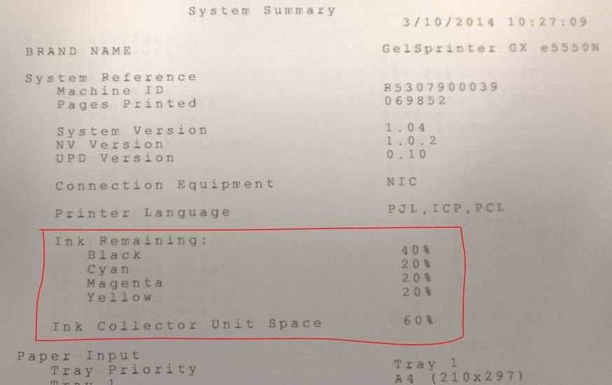

Re: Advice on the Ricoh SG3110DN for SubliJet-R sublimation printing
The LCD display isn't particularly accurate in displaying the ink levels. You can however run a report from the printer that gives an actual percentage level:
On the printer control panel on the front of the printer:
Press Menu
Press the ˅ (down arrow) button
Select ‘List/Test Print’
Press # button
‘Config. Page’ is displayed
Press # button
The printer will now print a 2 page report. If you look through the report you can see the ink remaining levels and also how full the waste ink collector is.
I've attached a picture of the section in the report.
