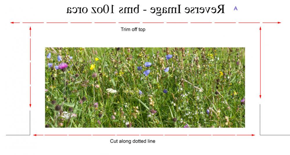

I have just had to create another mug template to cope with mugs that taper at the bottom. Supposed to be good quality but I guess this happens. Anyway the print quality is visibly reduced. I think 7mm (was 5mm) top/bottom margin is ok - for my application. How close to the handle you can print is probably determined by the heated area of the press and again I would not push this too far.
I use an A4 sheet for each mug and don't worry about the 14p cost per page. I trim (Rotatrim) according to the guide marks leaving about 10mm sticking out above the mug. This give me something to grab when peeling off the paper after pressing.
Trimming the base lets me offer the paper to the mug with both on the table to keep it level all round while pressing down the tape.
Probably the easiest thing is to print on a4 and experiment to see where/if the image starts to fade on all 4 edges.
[ATTACH=CONFIG]2986[/ATTACH]
