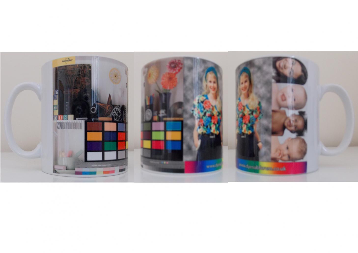

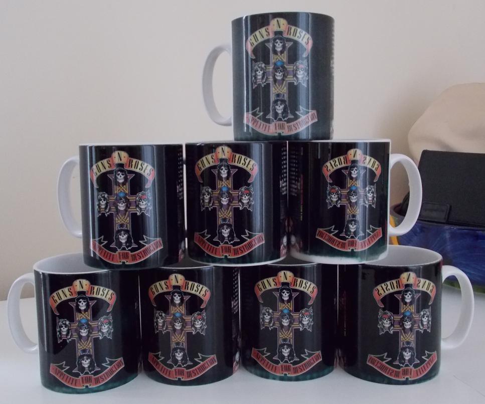

Ok, so I have used the recommended colour test template and adjusted the heat and timings as per everyones comments and "eureka" what a result! See image below - The photo just doesn't do it justice as it was hard to get the lovely bright colours to shine through:
[ATTACH=CONFIG]2855[/ATTACH]
Now the bad news - "Appetite for Destruction"

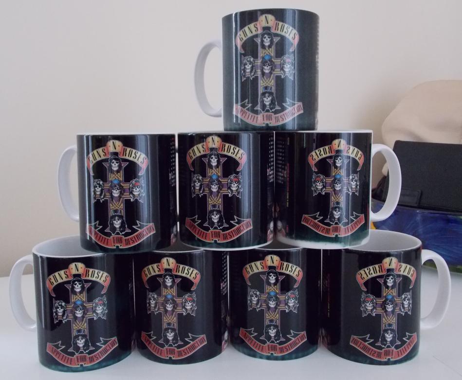

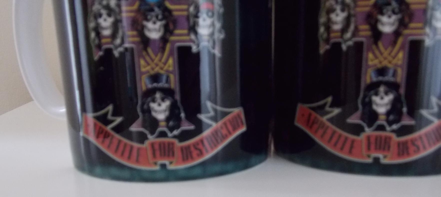

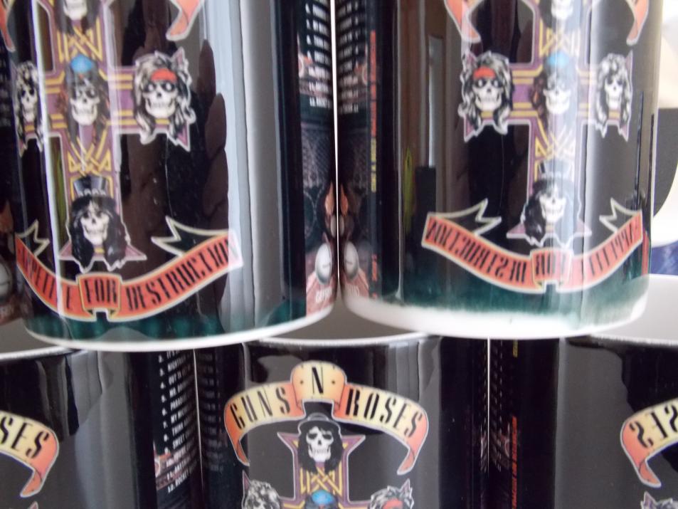

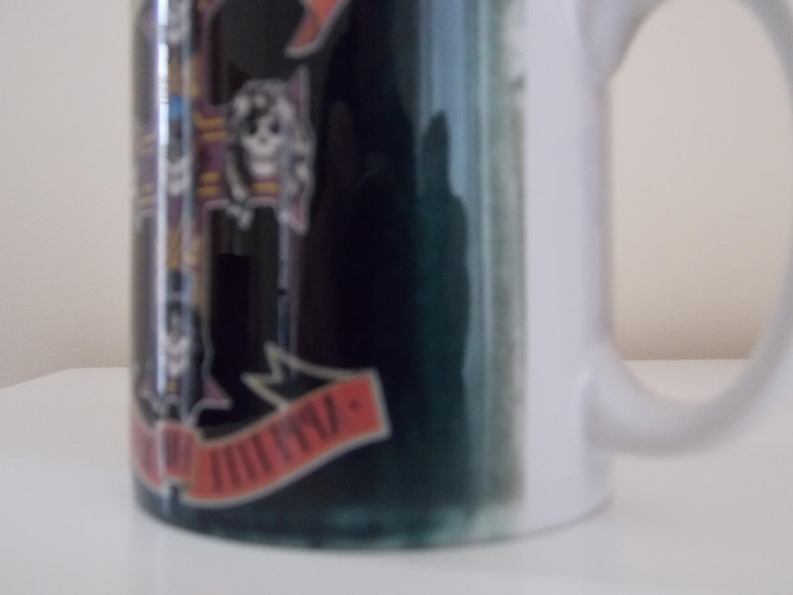

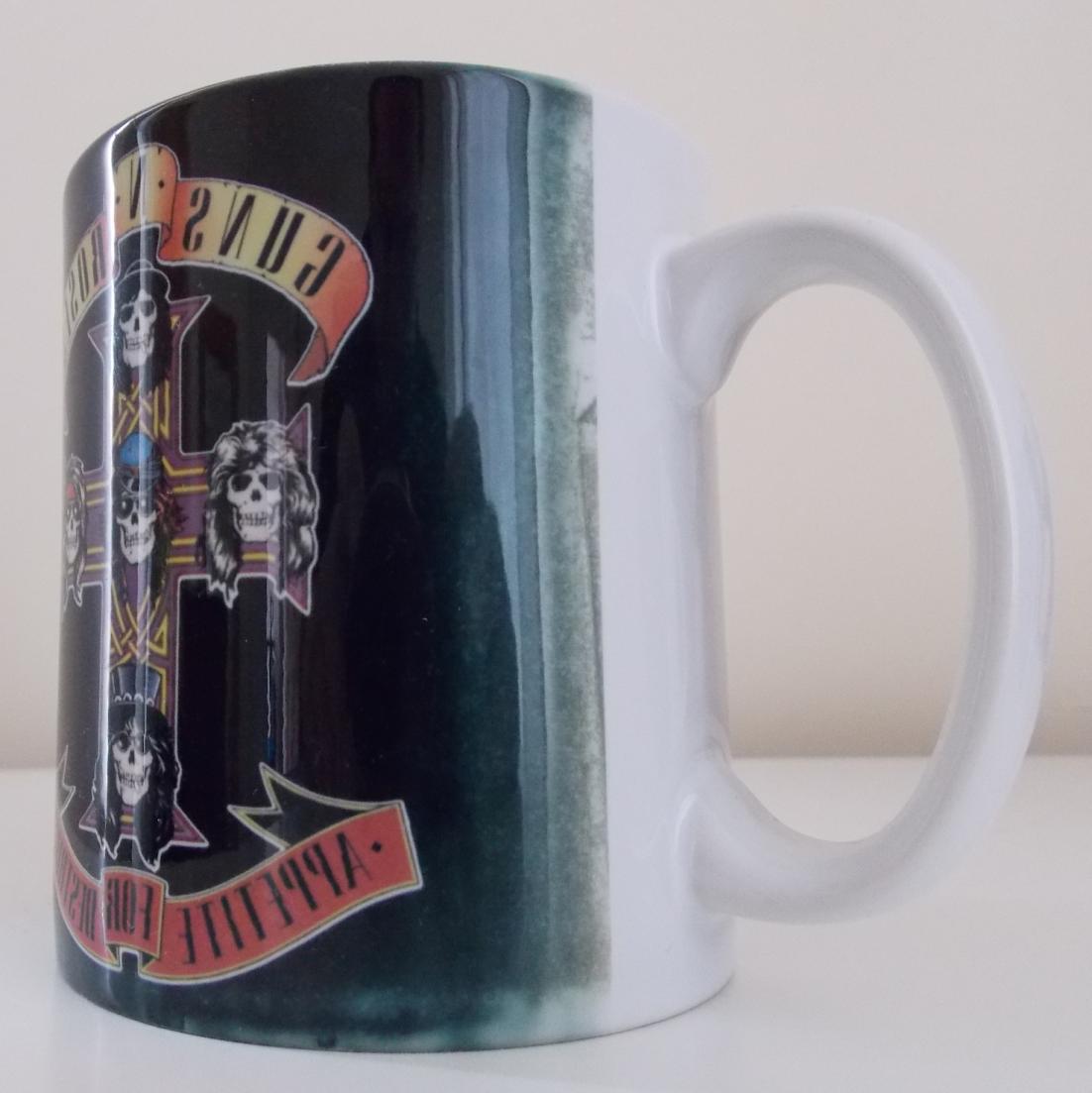

I then created an image that I wanted to sublimate onto some mugs (the album cover from the amazing Guns and Roses "Appetite for Destruction") but the results were not good despite trying different durations and temperatures? I just don't understand why the colour test template came out so well and the GNR mugs look blurred and perhaps scorched at the bottom edge the main part of the mug looks great but its around the edges, see photos below...
[ATTACH=CONFIG]2857[/ATTACH]
[ATTACH=CONFIG]2858[/ATTACH]
[ATTACH=CONFIG]2860[/ATTACH]
[ATTACH=CONFIG]2861[/ATTACH]

In answer to your question, its to do with the mug base.
When you put a mug in the heat press the main body of the mug gets hot pretty quickly, but the base takes a lot longer as the immediate heat generated by the blanket is "sucked" into the base.
There are many suggestions and the one I favour and use is to use a teryaki grill to heat the mugs before putting them in the press. This helps because the base of the mug will even out to a similar temperature to the rest of the mug very quickly.
You can try things like putting them on radiators and I think someone else suggested putting boiling water in them for a few minutes.

Hi again Socialgiraffe,socialgiraffe;89885 wrote:In answer to your question, its to do with the mug base.
not offended in anyway you are just trying to protect the interest of your client and I respect that! In my day job I have to regularly deal with software IPR issues especially in respect of using some open source gizmos so very much understand where you are coming from.
I will experiment with some pre-heating methods hot tap water in the cup prior to pressing seems like a good solution, would I need to also reduce the press time?
I too gave up smoking 22 years ago but sometimes still after all that time fancy a piggy, especially in a beer garden with a cold beer or arriving in the middle of nowhere after a long adventurous bike ride. Don't turn back no matter what the stress or temptation
Thanks again for the tip I will let you know the results.

Water in the base can work but needs to be boiling hot and a bit of a faff. Personally I pre-heat the lowest inch of the mug in the press at full heat for 20/30 seconds. If you have a few to do the trays are a great idea or you can sit them on top of your flat press if you happen to be using that as well.
