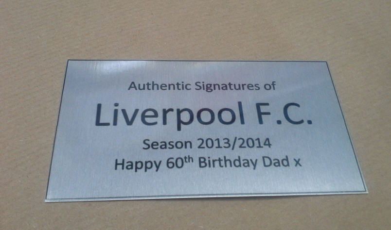

Hi, I'm a Picture Framer by trade and a few years ago I invested in a Ricoh
GXe3300 so I could print the nameplates for my framed Footy shirts ( see below ).
[ATTACH=CONFIG]2847[/ATTACH]

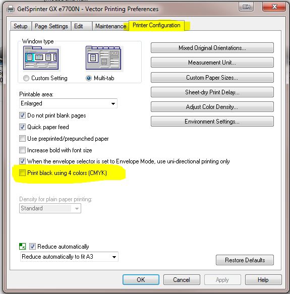

If you are not using the Powerdriver software you can set the printer to only use black when printing black.
Go devices & printers -> Ricoh printer -> printing preferences -> printer configuration and untick "print black using 4 colours"
[ATTACH=CONFIG]2848[/ATTACH]
