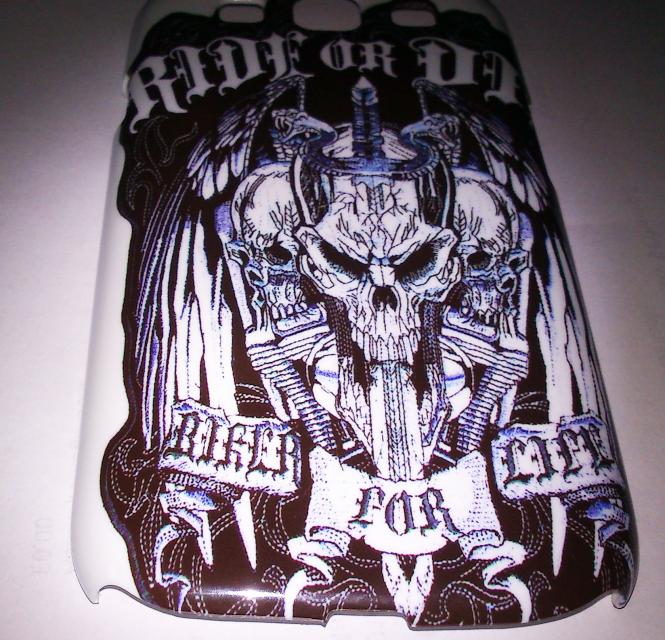

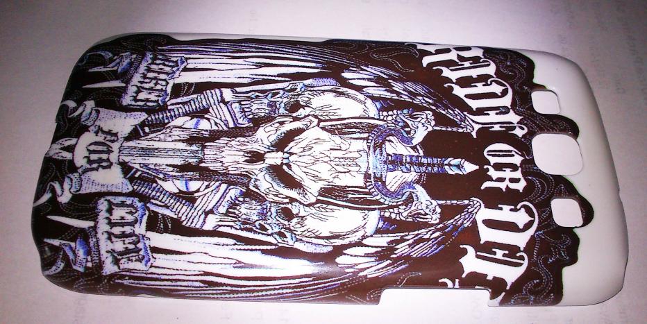

film gives better print.....more detailed i find.....but is a pure bugger to get lined up right....eps if you got text and it has to be in certain place on case...
need to figure that one out here....
the paper lay down on bench - clip the case to the mold first..then lay both on the image - tape up....easy as - :wink:

i got the reverse.
better/brighter and more detail with the film...just need to figure out how to get them lined up right :rolleyes:
[ATTACH=CONFIG]2743[/ATTACH][ATTACH=CONFIG]2744[/ATTACH]
