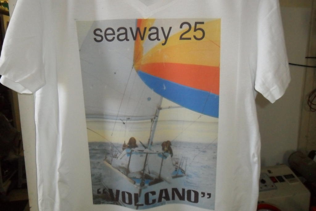

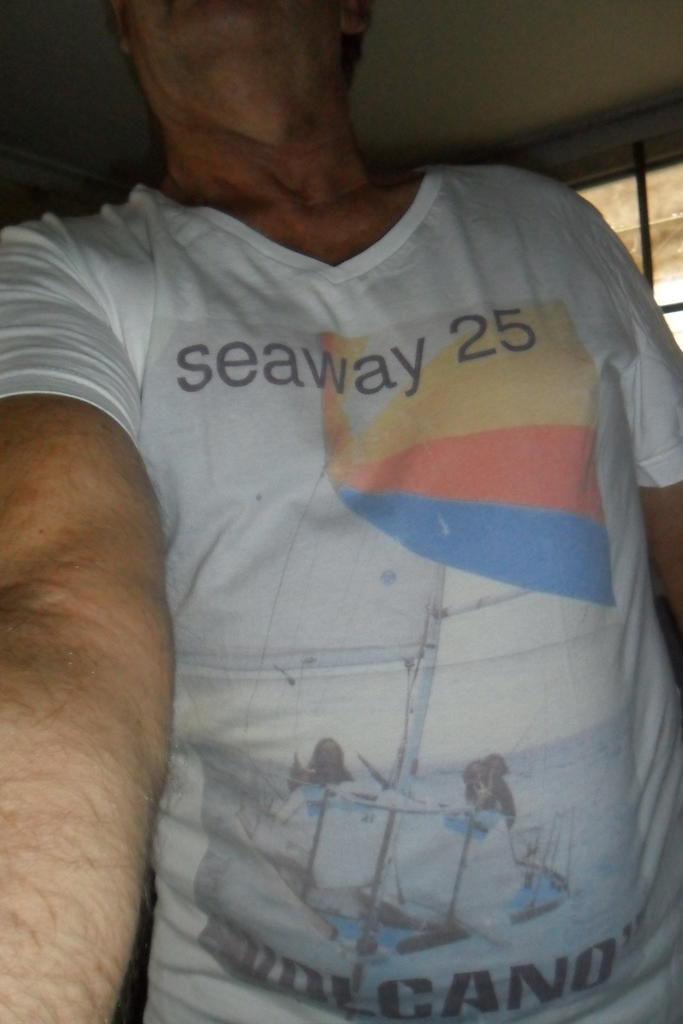

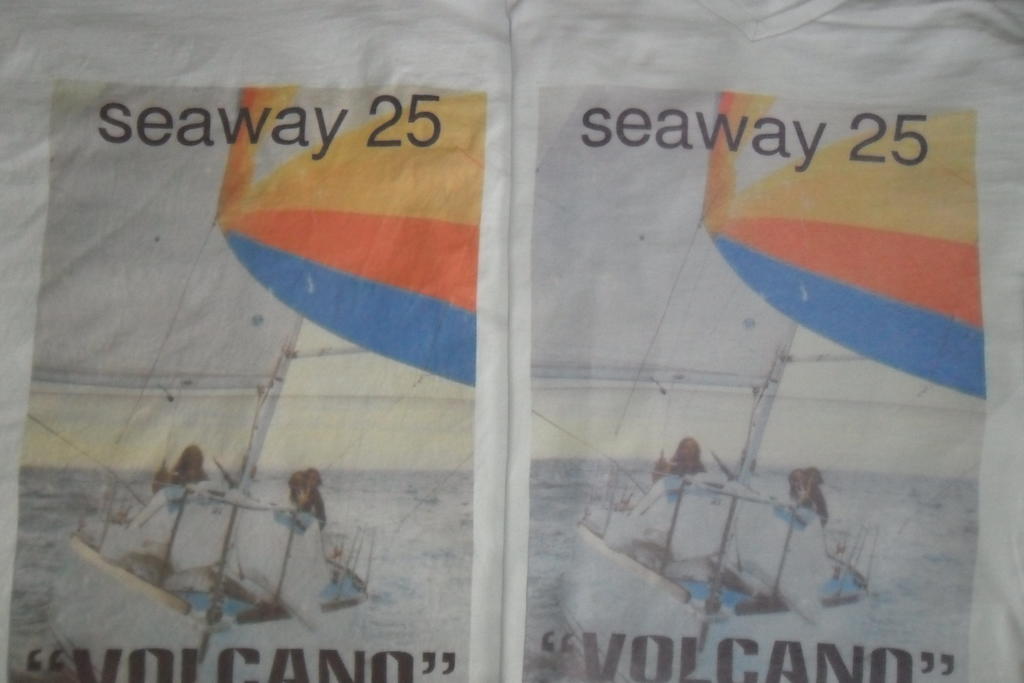

[ATTACH=CONFIG]2478[/ATTACH][ATTACH=CONFIG]2479[/ATTACH][ATTACH=CONFIG]2480[/ATTACH]
Ok, for the couple of people I know are messing around in this experimental stuff, or at least following it. Here is one of the shirts from a month or so ago.
The first pic is as it was first sublimated.
The second (me wearing it) was after some washes. There's one of it wet a few pages back in this post.
The third pic shows one on the left that I accidentally printed upside down and kept as a comparison shirt (never washed), and right of it, the shirt in the previous photos after 10 hot washes and mostly hot tumble dries.
In the first 2 washes any colour that was going to come out, seems to have done so. Since then I am getting the usual brushed cotton 'down' across the print that is normal for cotton that is not dyed in the factory. So this gives a distressed look.
When it is wet, this shirt looks like it was just printed. As it dries the white fibres across the surface show. Not everybody's cup of tea I'm afraid, but it works for what we want until we can improve it.

vB_ID:2480
vB_ID:2480
c- left as pressed right after 10 hot washes.JPG (75.6 KiB) Viewed 109 times
vB_ID:2479
vB_ID:2479
b- after 5 hot washes.JPG (75.35 KiB) Viewed 109 times
vB_ID:2478
vB_ID:2478
a- as pressed.JPG (72.86 KiB) Viewed 109 times
