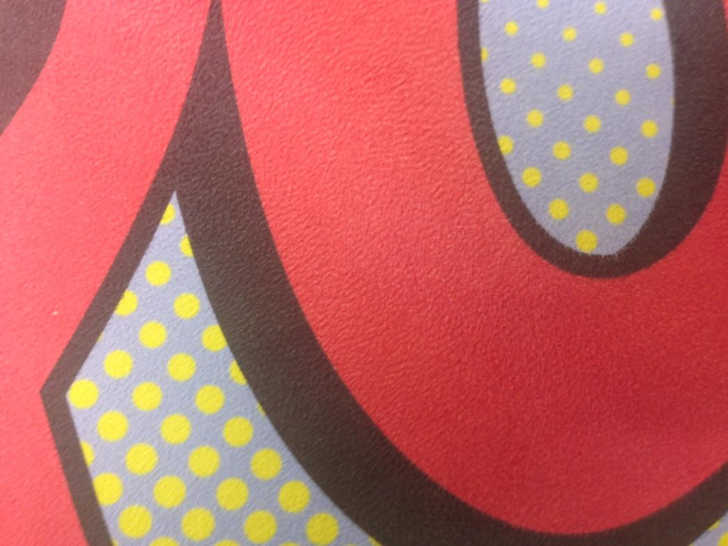

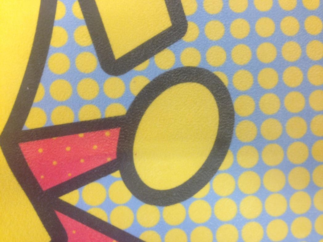

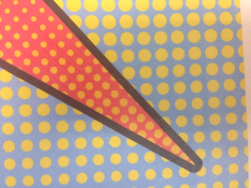

Here is some of the results I'm getting, the one in the middle was pressed on a hard bed with no foam. The others are pressed on the aluminium sheet on top of the foam.
[ATTACH=CONFIG]2521[/ATTACH][ATTACH=CONFIG]2522[/ATTACH][ATTACH=CONFIG]2523[/ATTACH]
Any thoughts on how they can be improved?

Craked it! you was right Pisquee it was the paper, the results are so much better. Your right about the ink sitting on the paper and letting it dry. Thank you for all your help.
