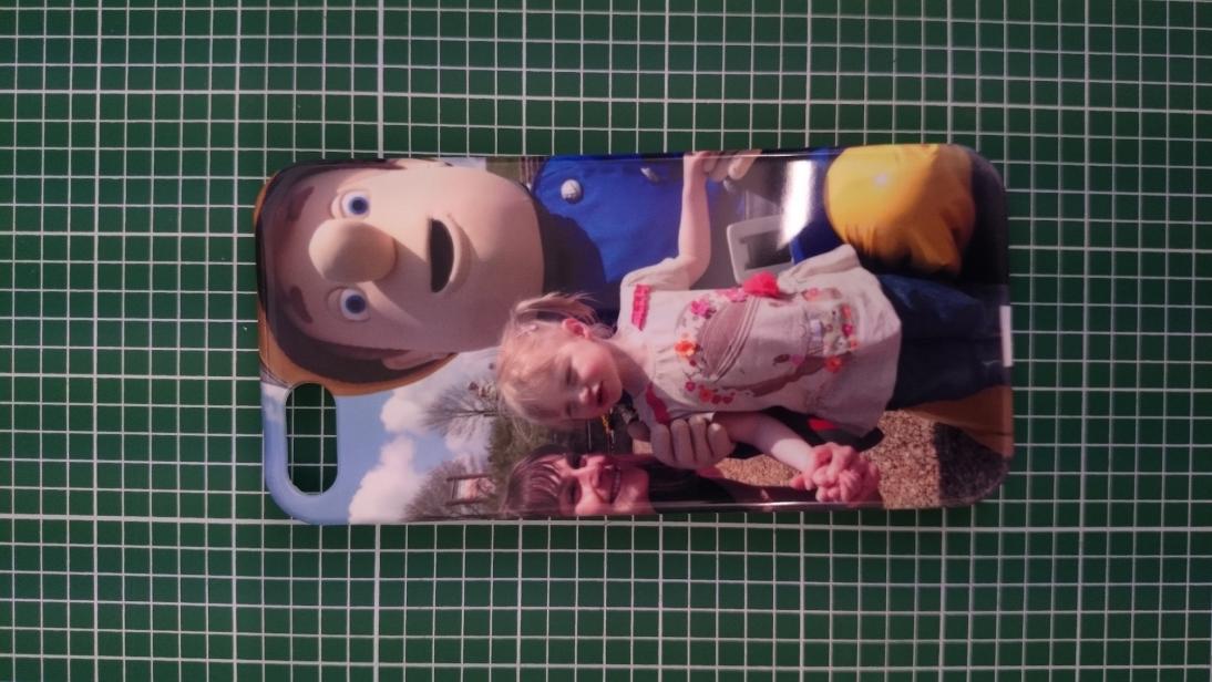

Well - Thanks for all your help. I think I've finally nailed it. test case #25 was perfect (see "goodcase1 attached)."
Pisquee, I did try your settings but unfortunately they didn't work - could just be my machine (pre-heating the puck fully really helped though).
It seems I just wasn't cooking them long enough.
Just in case it's useful for anyone in future here's my process. I've repeated it and so far so good.
I'm using:
Powerdriver v.4 (latest one from Sawgrass website)
Ricoh 3110DN
3D Heatpress (model ST3042)
Gold Polijet film - 180microns
Photoshop CC with standard powerdriver settings (as instructions on sawgrass PDF)
1) Once image is printed onto gold film I dry it for 3 minutes, (I stick it next to the air-con fan but this may be overboard).
2) Pre-heat puck to 170c
3) Place case onto puck
4) Position case/puck onto film
5) Place sheet of grease-proof paper the same size as face of case (too big and it will imprint on your corners), on top of film (gold side).
6) Heat in 3d Vacuum press at 170c for 10 minutes.
Thanks again and I'll update if I discover anything.

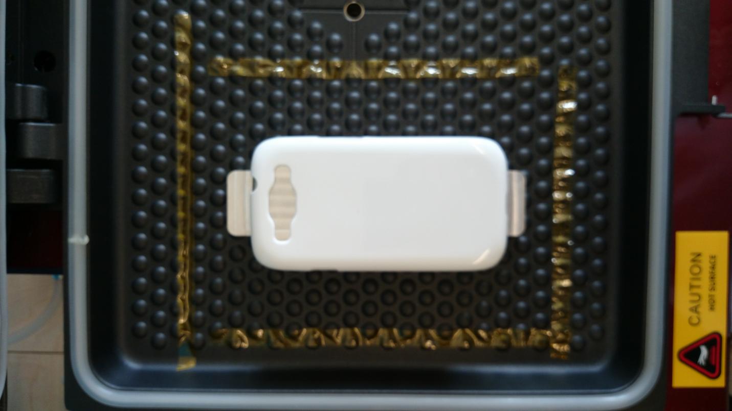

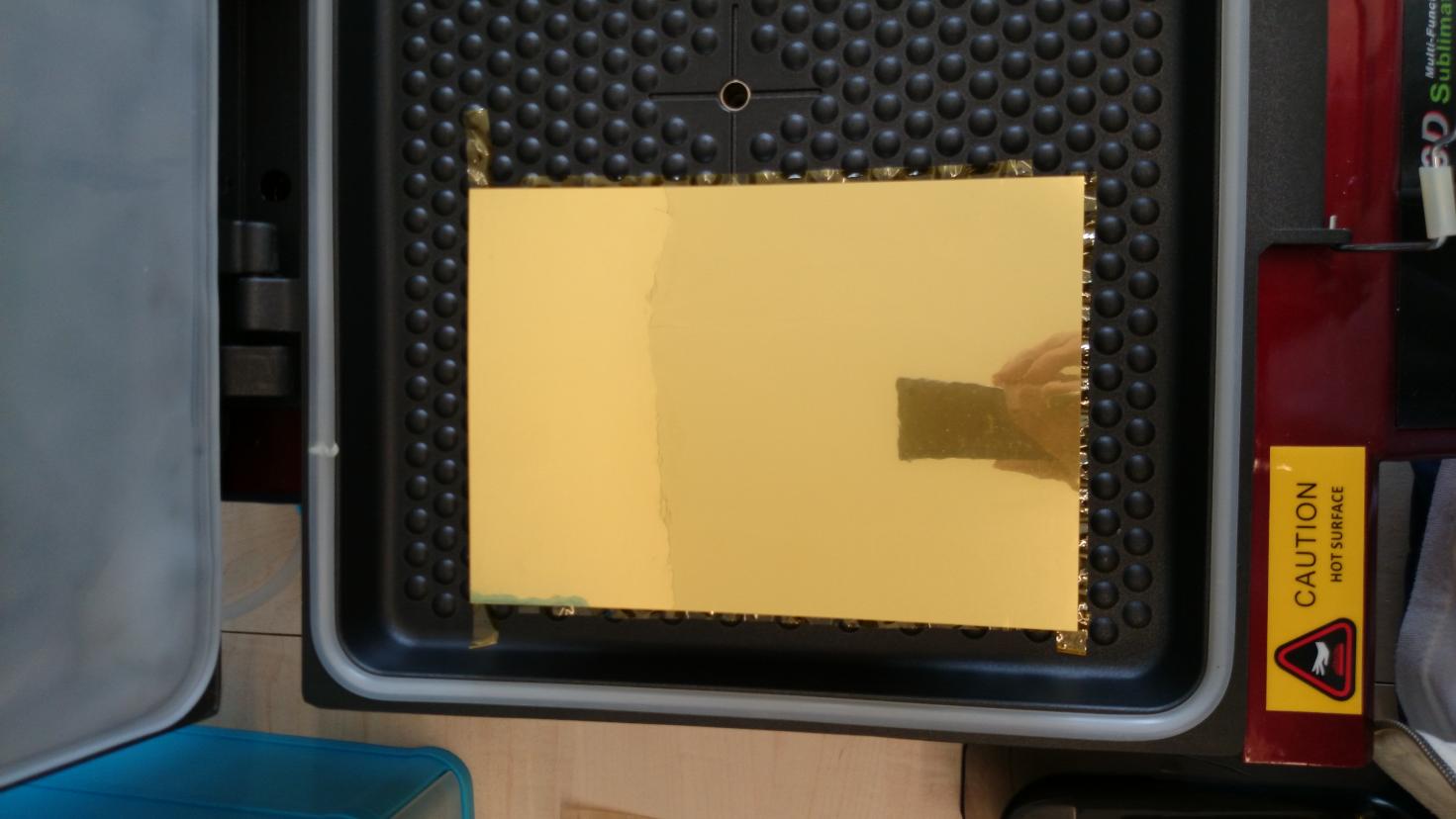

Hi cybalokz,
I've tried a few methods and here's what works best for me:
1) Mark out a template on base of machine using heat-proof tape making it the same size as your film (see template1).
2) place substrate/jig assembly in centre and lay film over the top so it lines up with your template (see template2).
3) close-up and away you go
I now leave this template there permanently so there's no faffing around when I want to make a case.
Cheers,
John.
There is a tool available but it's pretty clumsy and I was advised not to use it.cybalokz;85093 wrote:@Ucase Do you need a special tool to use film with the st3042, i have same machine but just use trupix paper at the mo? would like to try out the film
Cheers,
John.
