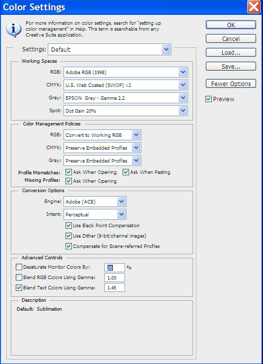

Re: ICC and Photoshop CS6
Softproofing is great, especially if you put gammut warning on too, I do a lot of work with soft proofing on all the time, is great been able to see in real time what the end result is going to be.
Interesting that the soft proof shows the bricks in the correct colour, but it doesn't print correctly.
In the video, I would say it would be better to use Adobe 1998 for the RGB colour space profile, and they don't talk you through the main colour management setup in Photoshop, which should look like this:
[ATTACH=CONFIG]2310[/ATTACH]
To get to this menu, with no files open, pull down the edit menu, and select colour settings (I think it's called)
Going through this menu with no files open sets this as your default colour settings, but good to save it as a preset as my photoshop seems to change it mind sometimes, so is something to keep an eye on.

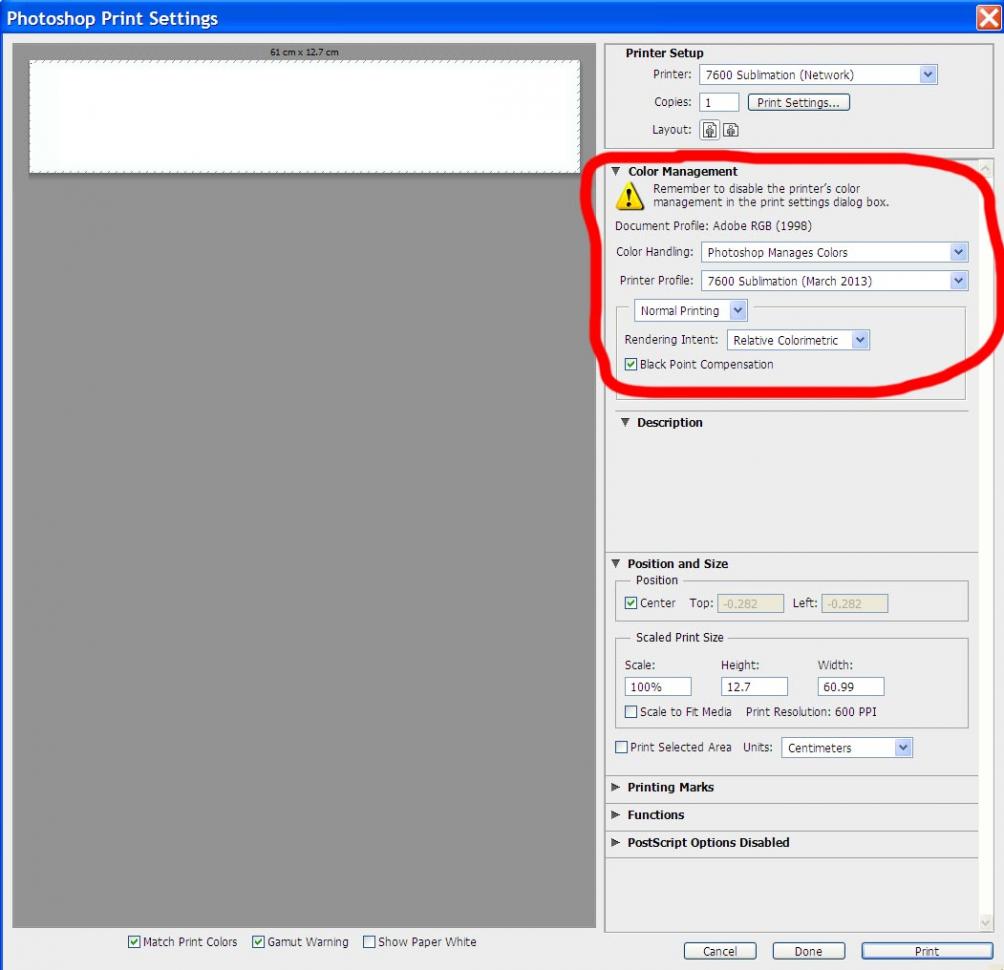

- vB_ID:2310
- Photoshop Colour Management.jpg (81.26 KiB) Viewed 193 times
- vB_ID:2309
- Photoshop Printer Colour Management.jpg (78.72 KiB) Viewed 193 times
Hi Pisq.
In the second thumbnail I assume under "Printer setup - print settings" you go in there and ensure that colour management is off, and the same details (DPI, paper type etc) are all as they were in the when you did the profile.
Sorry, didn't see your reply - but yes, you want photoshop set to manage colours, and select the ICC there, and in the printer driver settings, have colour management off and all other settings the same as when you printed that charts.
Important to have your general colour management (from the first image) set up properly so everything else is running consistently.
