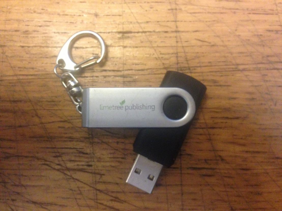

When this thread first started I managed to find a twister style USB drive in my drawer. I cleaned it up and heat pressed on to it a logo using CPM 6.2 Hard Surface Light from The Magic Touch (see picture). I have carried the USB key around and used it like a normal pen drive. The logo is still on the drive and has not scratched at all. So if you have a good supplier of blank drives you can personalise them very cheaply.
This one does not have any after coating but personally I would still recommend a quick dusting with varnish before putting back together but that is up to you.
