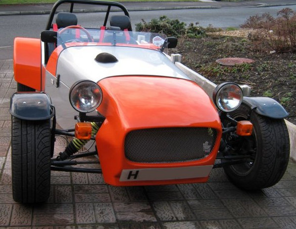

Home made and goes in class 2D[ATTACH=CONFIG]1873[/ATTACH]
