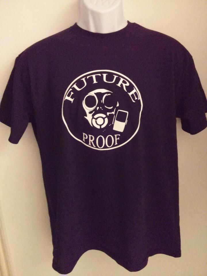

id second the comment about viny, the pic attached is done in vinyl and the white is nice and bright, its mdp hot flex and has a nice matte finish when pressed.[ATTACH=CONFIG]1805[/ATTACH]
vB_ID:1805
vB_ID:1805
future proof tshirt.jpg (64.36 KiB) Viewed 232 times
