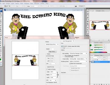

in colour management i can scroll down all the profiles are there including the new downloaded artainium but in photoshop the artainium can not be found i have added a screen shot[ATTACH=CONFIG]1764[/ATTACH]

Screenshot a bit small but I assume it just isn't appearing on the list...and therefore isn't installed?
