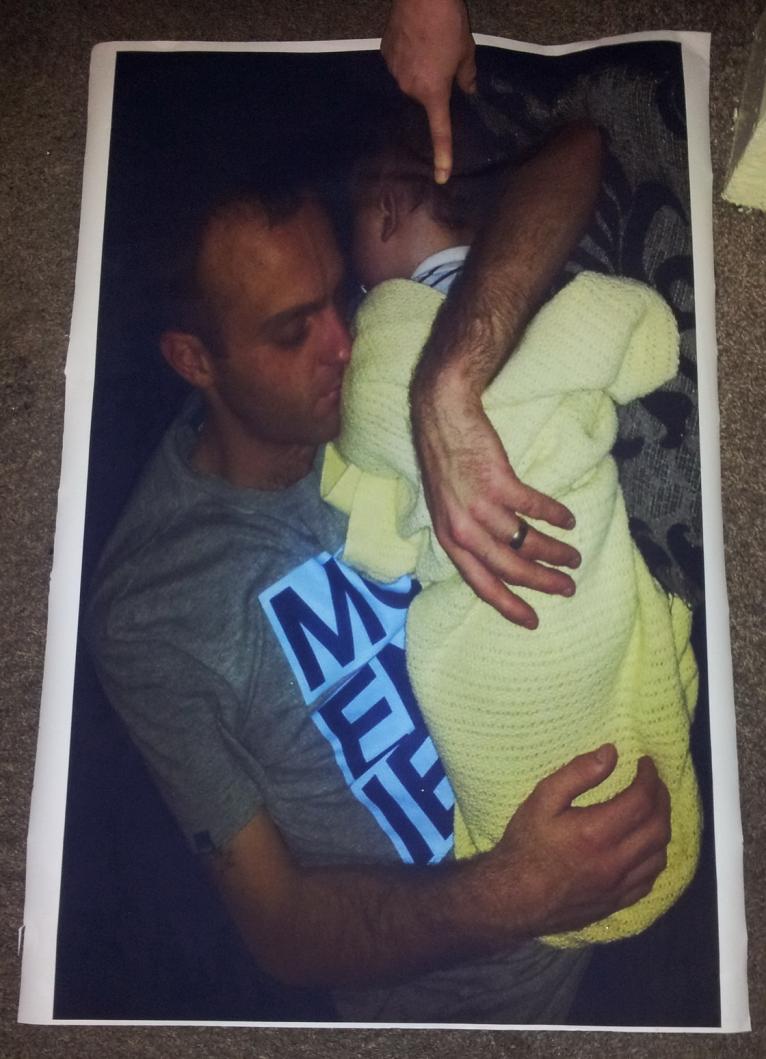

I want to do something like 36 x24 canvas prints.
My Son was here in the week with his Son and fell asleep on the setee.
I took a photo with my phone and have printed it off at that size for practice. (36 x 24in)
I think it came out really good, considering it was just a phone shot and printed on cheap inkjet paper.
What do you think?

It wont let me post the photo?
Ahhaaa, it was too big.
The hand pointing is just my wifes hand to get a perspective.

I was / am very pleased with the quality of the print considering it isnt a lot of money for a large format Printer.
I am just trying to get into it.
If I had the money obviously I have a wish list. But I dont.
I must say I am very happy how my pics came out on the test paper and very little knowledge.
