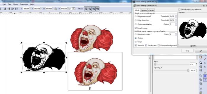

I think if you copy the whole image.. ((duplicate)...then group it all together, then fill the whole image with a solid colour, you can then use the trace function for the outline.
Or, use trace bitmap function, edit with 2 colours and invert image... should turn black and white. You then have an outline to work with. Hope thats correct.

as the image is made of black lines its still selects inner lines and to fill the image means i have to use the bucket tool and manually fill all areas which takes as long as drawing around image manually or am i doing something wrong, thanks for your help

i have a bamboo tablet i can use to draw around the image which would be quicker for me than the tutorial paul gave but thanks tho there are some things in there that i could use in future, my main reason for querying this is to cut down the time it takes to set something up for cutting i was hoping there would be a way that if the image had a white background I could trace only the outer edge in one or a handful of steps rather than whats shown in the tutorial as image with me detailed edges would take a long time
