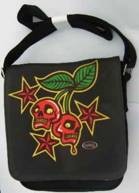

Post by gorgall2 »
Bag I did a while ago[ATTACH=CONFIG]1394[/ATTACH]
vB_ID:1394
vB_ID:1394
cherry skulls bag.jpg (17.24 KiB) Viewed 223 times
