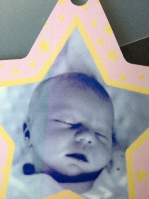

[ATTACH=CONFIG]1370[/ATTACH] Does anybody know why this is happening????? There is no pink on the baby's face on my computer so why does it print like this? Everything else is printing fine! (Ricoh sg3110) x

There are a few things to look at
Firstly, is the pink on the dye sub paper that you have printed? If it is there then it must be something with the file. If this is the case try converting the image to CMYK (or RGB if it is in CMYK) to see if the conversion gets rid of the pink cast.
Personally I think it maybe on your heat press and maybe from where you press the item after printing. Have you tried pressing with a clean new teflon sheet (or baking paper) between the printed paper and the heat press, that may work.

Try printing the image as a grayscale inside powerdriver if you are not currently. That might solve the issue.
