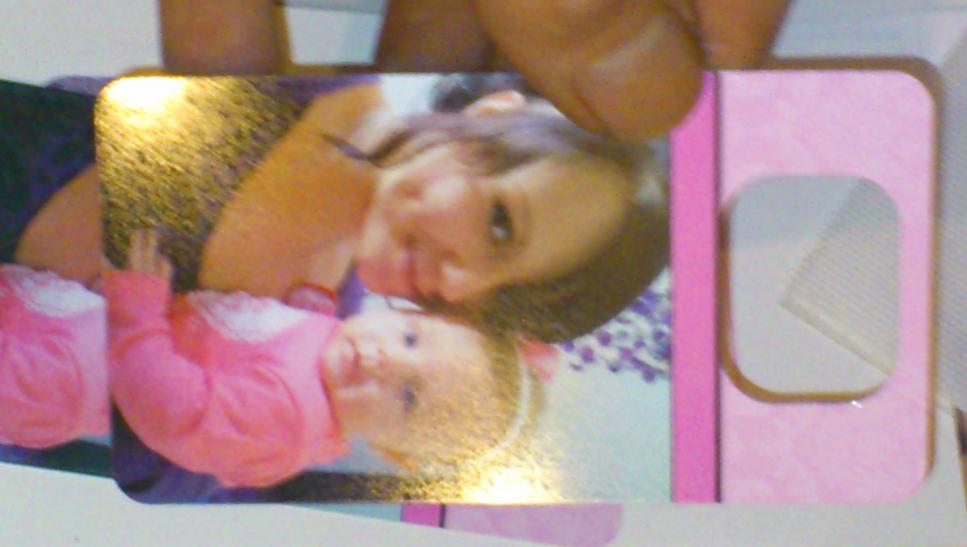

[ATTACH=CONFIG]1269[/ATTACH] apart from the light the haze around it is what i get all over the metal if looked at from the side is that what ur getting as well ??
vB_ID:1269
vB_ID:1269
Andrew
Posts: 2086
Joined: 01 Dec 2009, 05:00
Re: Printing Alu Panel iPhone covers
Post by Andrew »
Different batches of metals (even from the same supplier) will give different results. There are too many dodgy batches that come through which can further complicate working out problems. Sometimes it is just the metal that gives poor results.
