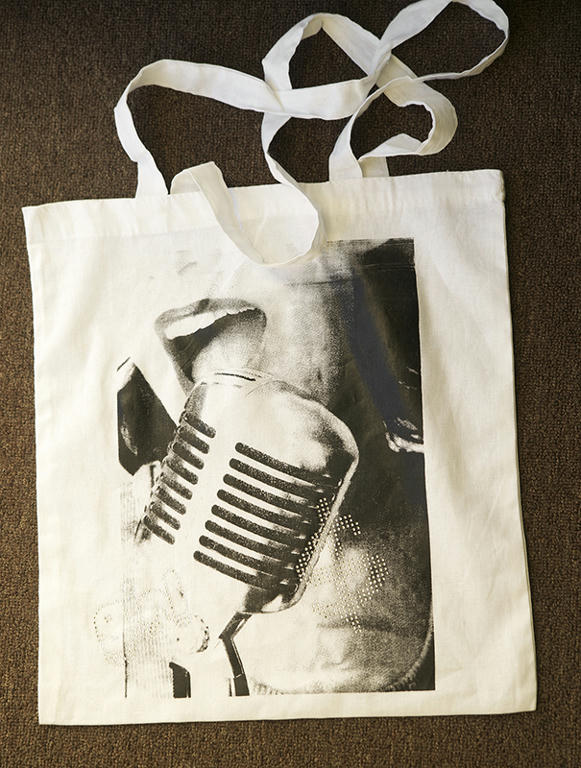

harlequeen;53641 wrote:I'm looking forward to seeing the first item off the press.
here it is :)

Paul;53750 wrote:here it is :)
Glad to see you have had such a good result Paul, what ink did you use for this print?
I notice some half tone like dots, was this intentional?
The bag, I have some of those thin cotton bags myself, was that something you had lying around and used for a test? If so have you printed on any thicker material?
regards
Tony
-launching july/august 2026
Re: DIY project - screen printing press
All picture is create of halftones. On the bottom u can see dollar sign made of rhinestones.
Ink i used is plastisol ink and i got it from wickedprintingstuff. Mesh used: 100T.
Exposed with 500w flood light.
I got thos bags frome here an decided to use it for test and i like it. When i find some time Nd some good design then i will print some tee and record while iam doing it. :-)
