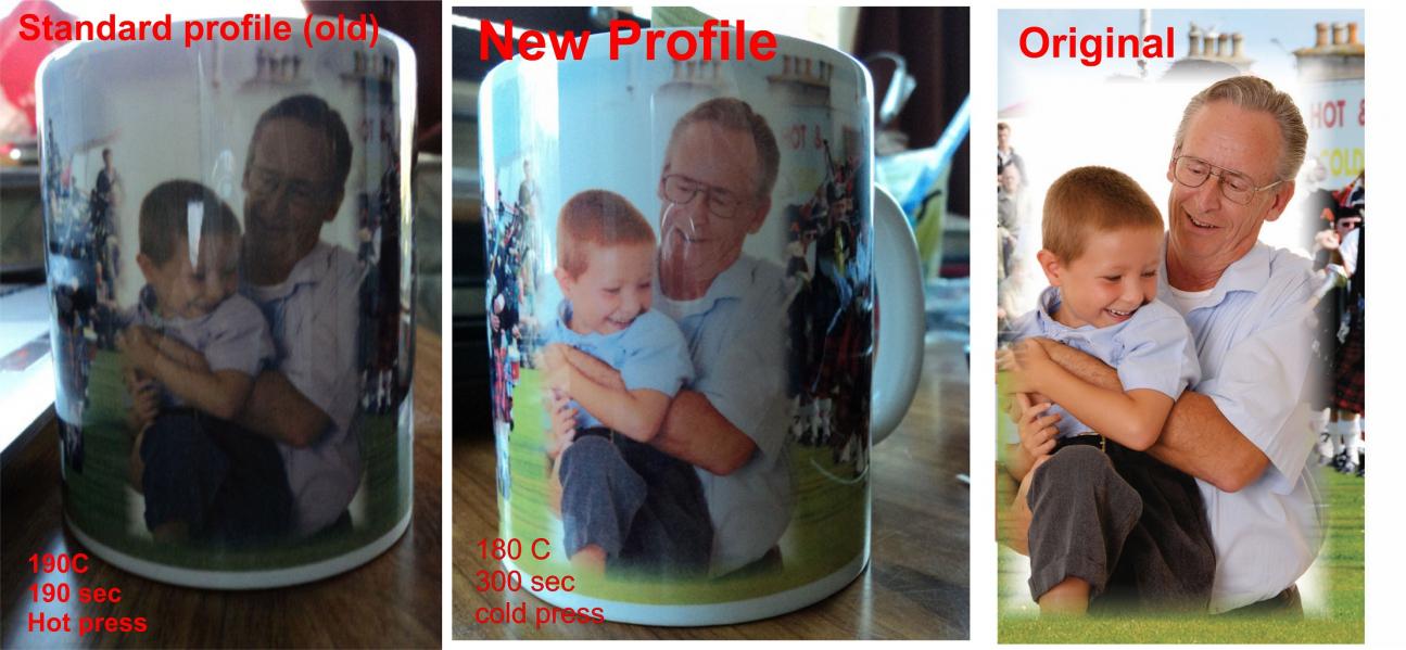

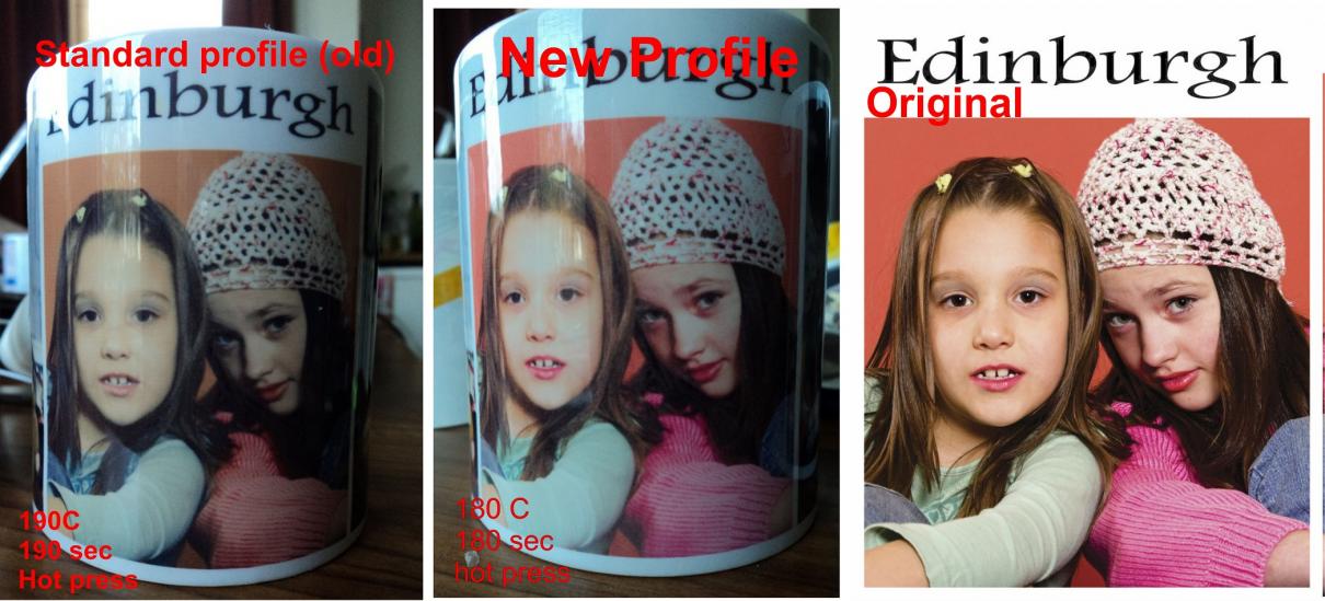

Yes, I have a new profile from Justin and I can see the BIG IMPROVEMENT (!!!!!!!!!!!!!!), at least people start look like people, but it's not an exellent result yet.

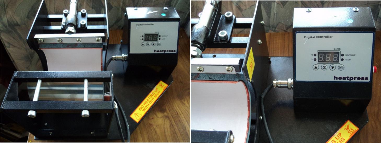

Here are the photos of the press and 2 mugs I done.
The outcome is not bright enough and it's still looking faint.

What parametres should I use for the press?

What pressure are you using Anna? Have you experimented with additional time and heat to see the difference?

Press look good. I would set it (I useto had one like this one!) at 185C for 180sec and this would be my starting point.
I can see huge improvment when printing with profile but its not as good as it should. old debate about all printers are diferent seemd to remind itself...
by you may get away with it by little bit tweaking but this will involve tweaking with every photo you print.
but agian... I would try diferent preasure as Justin mentioned
my starting poin for mugs is always medium/heavy.
all the best!

positive it's the press i have , but mine are perfect at 210 for 250 seconds

That increase could make all the differenceLornem;32460 wrote:positive it's the press i have , but mine are perfect at 210 for 250 seconds
