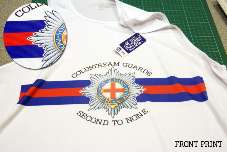

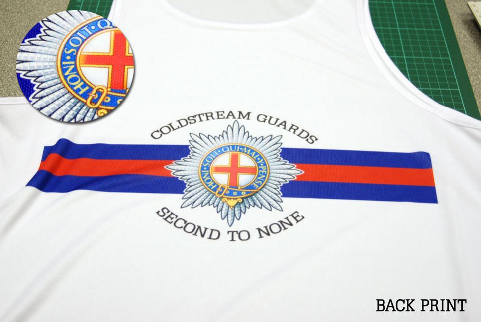

Thanks Paul - I was pressing the second side when you replied
It turned out well, I pressed for 185 for 65 seconds and used truepix paper ............. the image transfered well enough to give as an example but I'm interested to know what the difference would be using texprint paper, I have some so I'll wait on a mistake and test the two together.
Thanks mate
Thanks mate

images belowsmitch6;25475 wrote:that'll be a nice test to know the results Adam
I use trupix at the mo and wondered what the dif would be with textprint
[ATTACH=CONFIG]391[/ATTACH] [ATTACH=CONFIG]392[/ATTACH]
