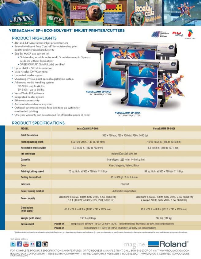

Found this on my old laptop. Can't upload as full pdf as file size exceeds limits.
[ATTACH=CONFIG]7341[/ATTACH]

I have the spec sheet pdf from Roland with the same Info but it only shows total height not height to bottom of machine.
Hard to explain but I have a worksurface where the printer is going to live which will need to be cut down by about 40cm, I may or may not need to cut down It all depends if the printer sits above the surface or not.
