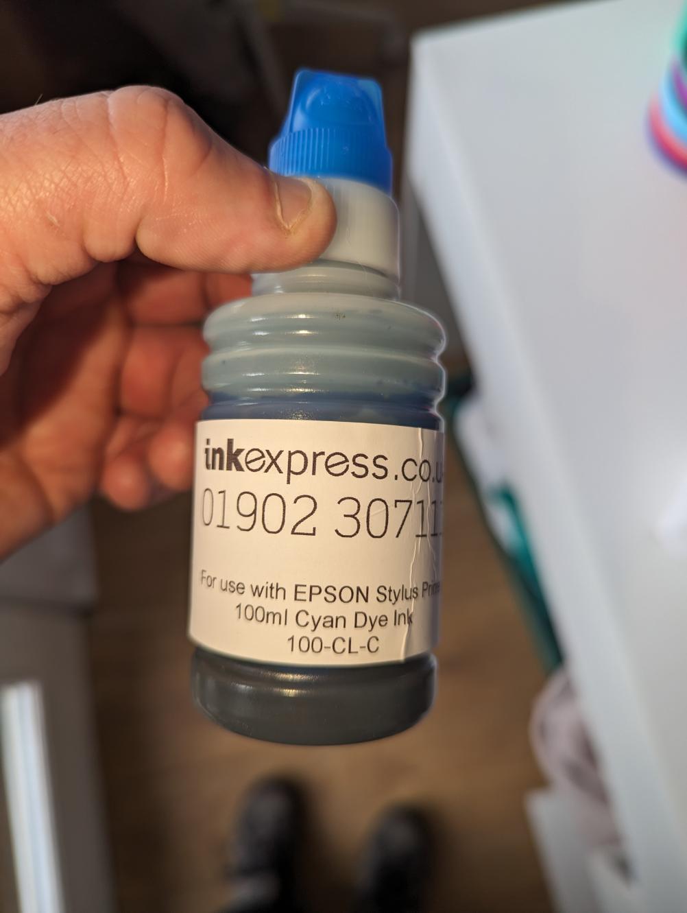

[ATTACH=CONFIG]7323[/ATTACH
This is the ink we got & the refillable cartridges with the chip.
vB_ID:7323
vB_ID:7323

Islandgifts.;153645 wrote:[ATTACH=CONFIG]7323[/ATTACH
It doesn't say sublimation on the label so it is a reasonable assumption that it is ordinary dye based printer ink.
You need to syringe the ink ouit of the carts, buy some sublimation ink and start again. Maybe buy some nozzle rocket to clean the heads or just run a few dozen test sheets on cheap copier paper to use the last of the old ink.
Or just buy a second set of carts.
