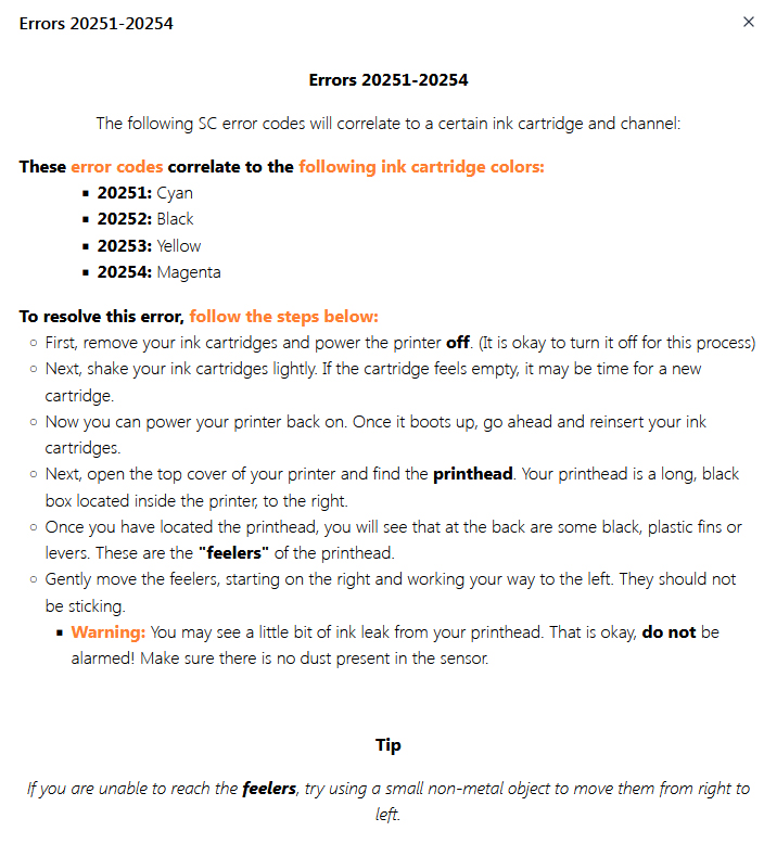

For those interested, I can't get rid of the ERR 20200 & 20252 messages. I believe these are the black cart and a head sensing issue???

This is as much as I can find on the SC20252 error. Don't know if it is of any help ...

I fitted new cartridges and also checked the optical sensor at the back of the head where the little head sensor fins are but still the same.
I do believe it's a mechanical issue rather than a component level failure but nothing I have done thus far has has resolved it. It's like the black line is failing to pull a vacuum to draw the ink through. In fact, I might go stick the breather plug in the cartridge to see if can draw a neg pressure.
