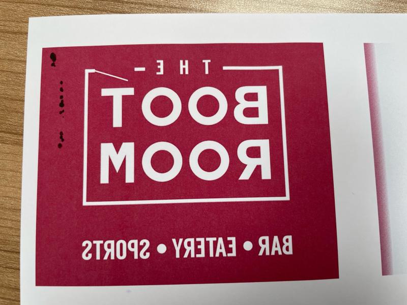

Got a bit of an issue with my printer, every other print I get black in marks on my paper, could anybody explain what's happening please?
[ATTACH=CONFIG]6756[/ATTACH]

I had similar problems with that printer and my L805; I found paper curling to be the problem. I now use Ink Experts "Versa" paper and have had no further problems.

That's the paper I'm using, its 6 prints on the bounce now :(

Could this be an icc issue?

This is now resolved, set the printer for envelopes along with putting a slight curve on the paper away from the print head
