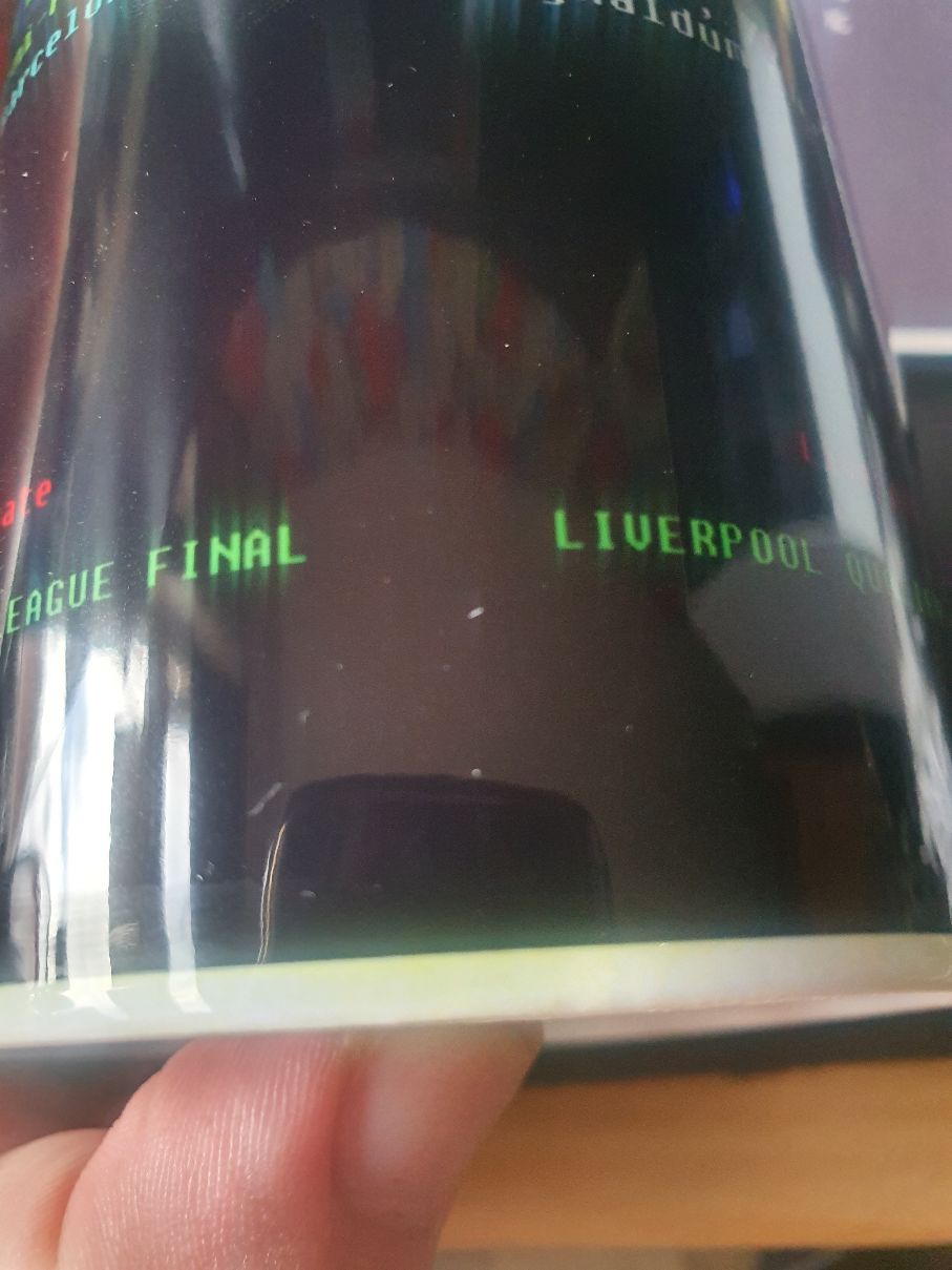

The main one is I keep getting yellow smudges on every mug in the same place. I have tried different setting, different mugs, different press, having them in a different way. Always in the same place so I can only think its the printer. I have done head cleans etc. I have also tested different temps and pressure nothing seems to make any difference.
[ATTACH=CONFIG]6616[/ATTACH]
Next it never prints straight always has a 1mm slant no matter what I do, had this issue on the old printer too. I have to cut of the edged as I get black ink splattered all down the edges. These 2 I can manage with, but the other is ruining every mug

If the yellow smudge isn't on the print before you press, it's not the printer. The yellow smudge is likely to be "gassing". If you do a search for "gassing" it'll probably bring up a host of helpful things.

Yeah looks like the press needs to be a bit tighter around the mug.

Thanks, I have tried this before but tried it last night as tight as I could before I break the mug and I still get the yellow
