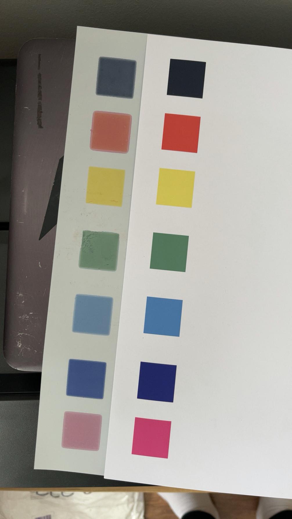

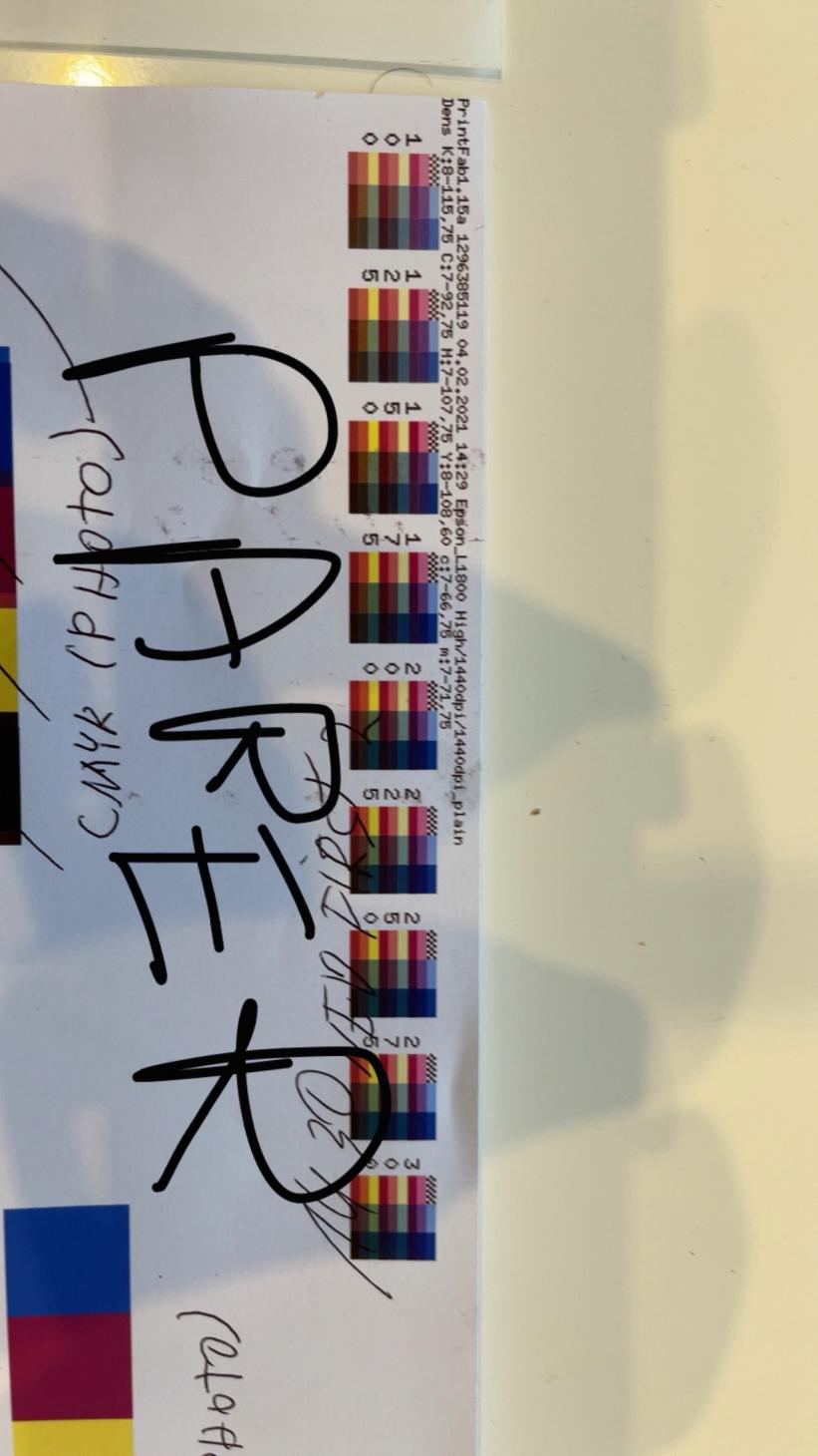

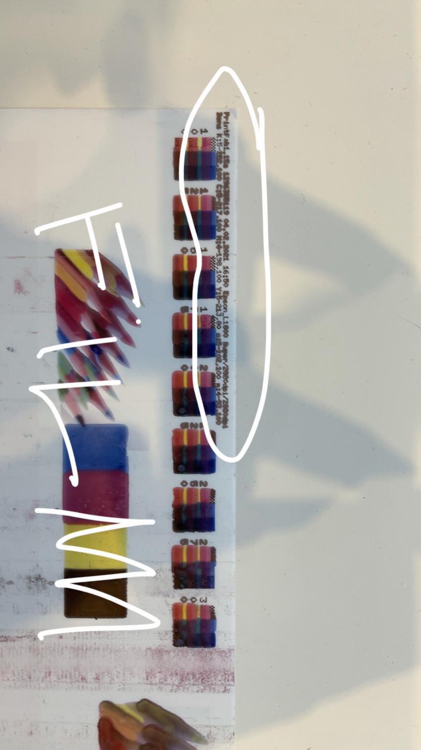

Soo, i made thousand of tests and hundreds of films printing with different settings and everything, even sunly technician watched all process and said everything should be fine. But I just think there is something wrong with the film or their inks. Film just can't absorb ink so that's why quality is very bad and bleed. On the sub paper it's all fine, but on film it's different. Adding some photos, maybe someone could explain:)[ATTACH=CONFIG]6555[/ATTACH][ATTACH=CONFIG]6556[/ATTACH][ATTACH=CONFIG]6557[/ATTACH]

Film is very susceptible to moisture. If we use film left out of its packet for a few weeks, we see results like those in your photo. We also use a small fan heater to dry the print as soon as it comes out the printer to reduce bleeding.

Hello, I've changed fim provider and problem is solved now! Sunfly's film is very bad, or it was defective somehow. :)
