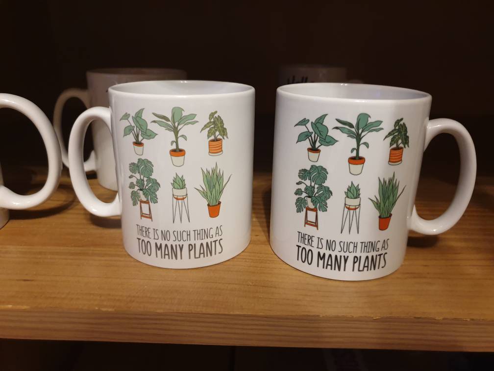

The one on the left is the freesub, I've tried it at 190 for 180 seconds. Given it more heat.
Right is the cheap 5 in 1 press on 180 for 180.
I just don't think the free sub is getting hot properly. [ATTACH]6462[/ATTACH]

Mrteajunkie
Posts: 1237
Joined: 13 Nov 2016, 21:59
Has thanked: 6 times
Been thanked: 4 times
Re: Freesub ST210 recommended settings?
Post by Mrteajunkie »
That free sub is not right mate.
I reckon your either stick on f not c or the blanket is duff.
NickH
Posts: 96
Joined: 07 Sep 2020, 23:46
Post by NickH »
Mrteajunkie;146420 wrote:That free sub is not right mate.
I will get in touch with the supplier again with the examples, it's been like it pretty much since the day I got it. Hence doing everything twice.

John G
Posts: 3008
Joined: 15 Nov 2009, 05:00
Post by John G »
If this happened on both blankets, I'd guess it must've been operating in Fahrenreit.
180f converted to C would be 82c - which explains why you could handle the mug without getting burned fingers - lol
NickH
Posts: 96
Post by NickH »
It shows C on the screen though.
The other day it did switch to F and was showing 300 odd but after I powered it off it went to C again.
If it is 82c surely it wouldn't do anything at all?
