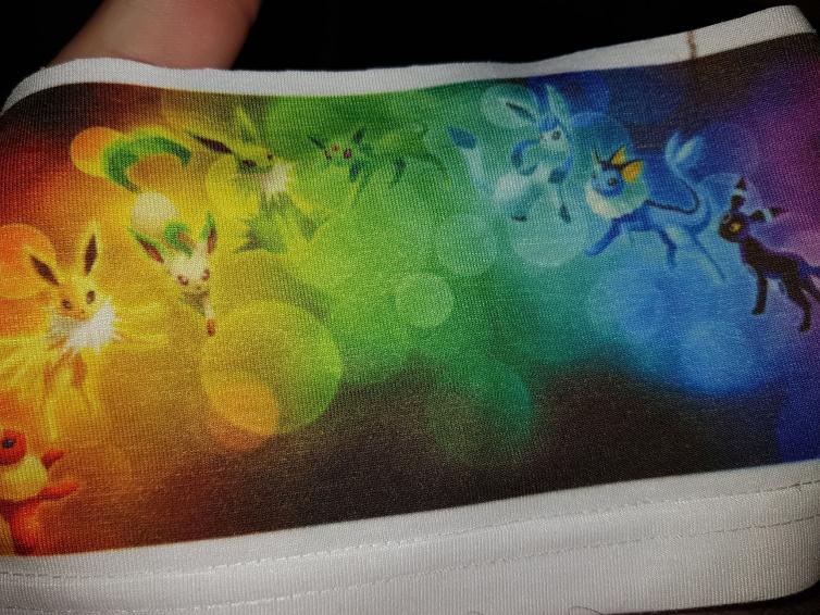

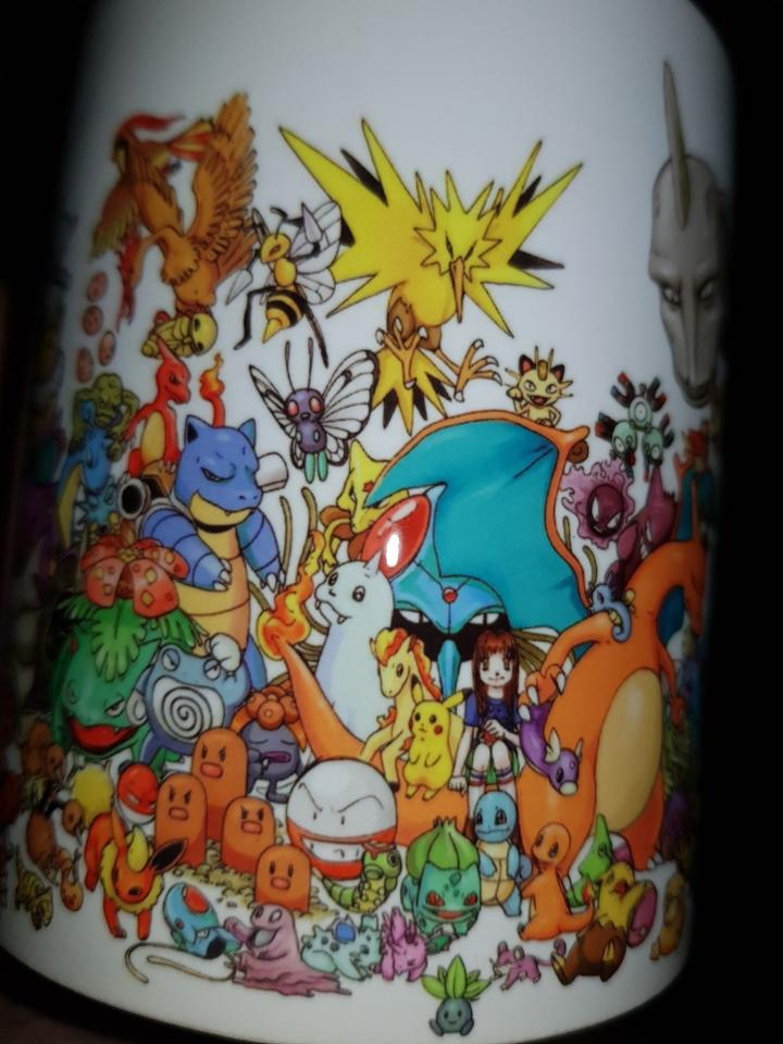

Hi all,

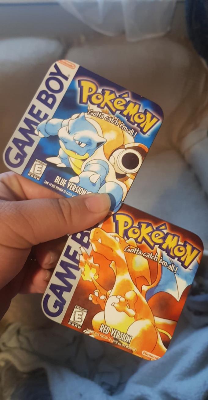

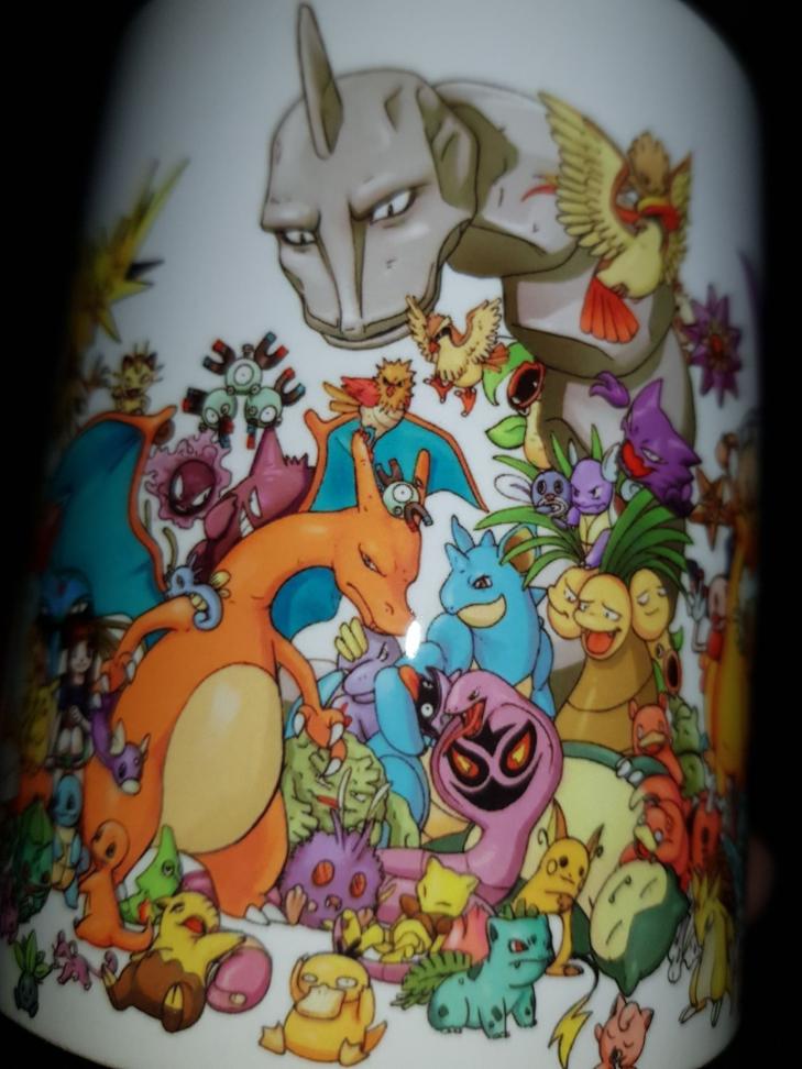

just wanted to write a post about my last month or so since starting this hobby
i use an epson ET-7210 with ink experts sublinova inks and versa paper (now started with city ink express ink and paper not great)

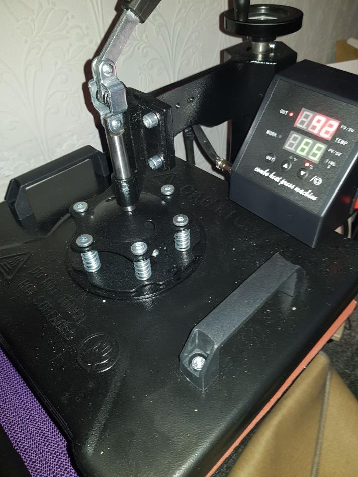

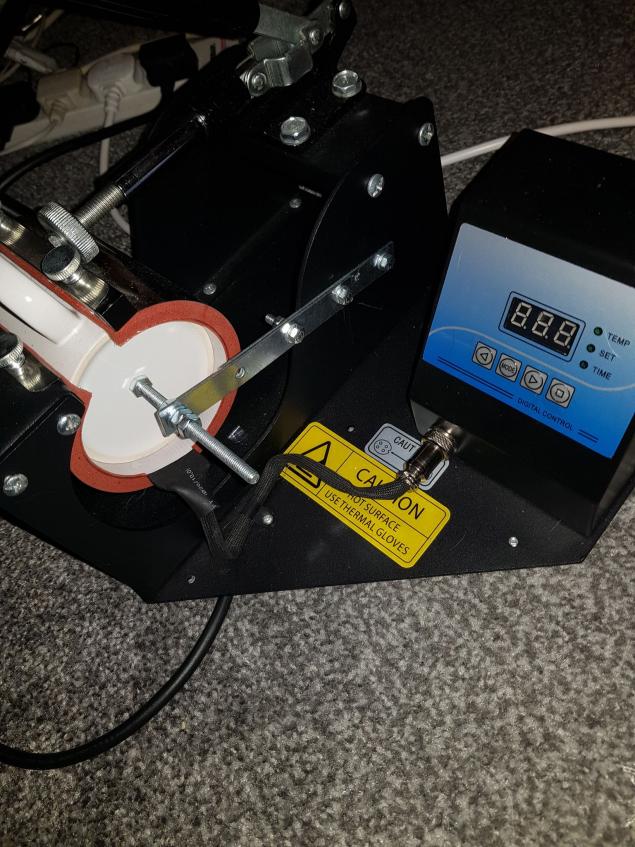

and my presses aint great pixmax mug press (added a bump stop mod see pics) and a 8 in1 uk press 15inx12in i got off signzworld (with DSF vip discount)
Mugs im doing idle 160 press 180 for 45 seconds and they look good no faded bottoms colours come out great etc

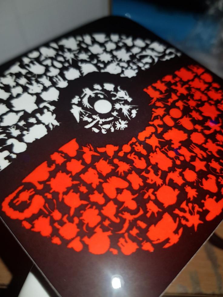

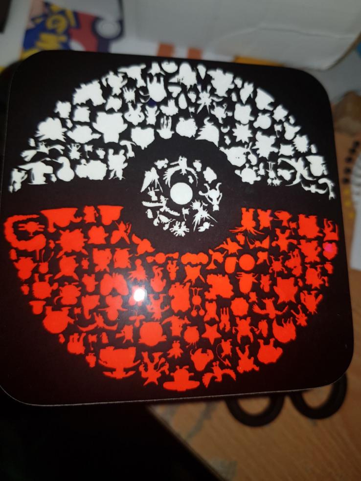

coasters is 190 for 65 seconds
fabric is 200 for 70 seconds
(pictures added)
i have already had my family and friends asking me the print them stuff
and a friend that own a business wanting business mugs so this hobby looks like it could pay a little back (win win)
anyone has any tips or tricks or anything i should look in to i would be grateful
thanks michael
