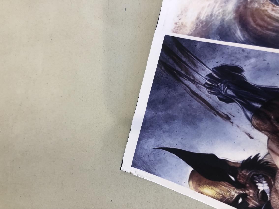

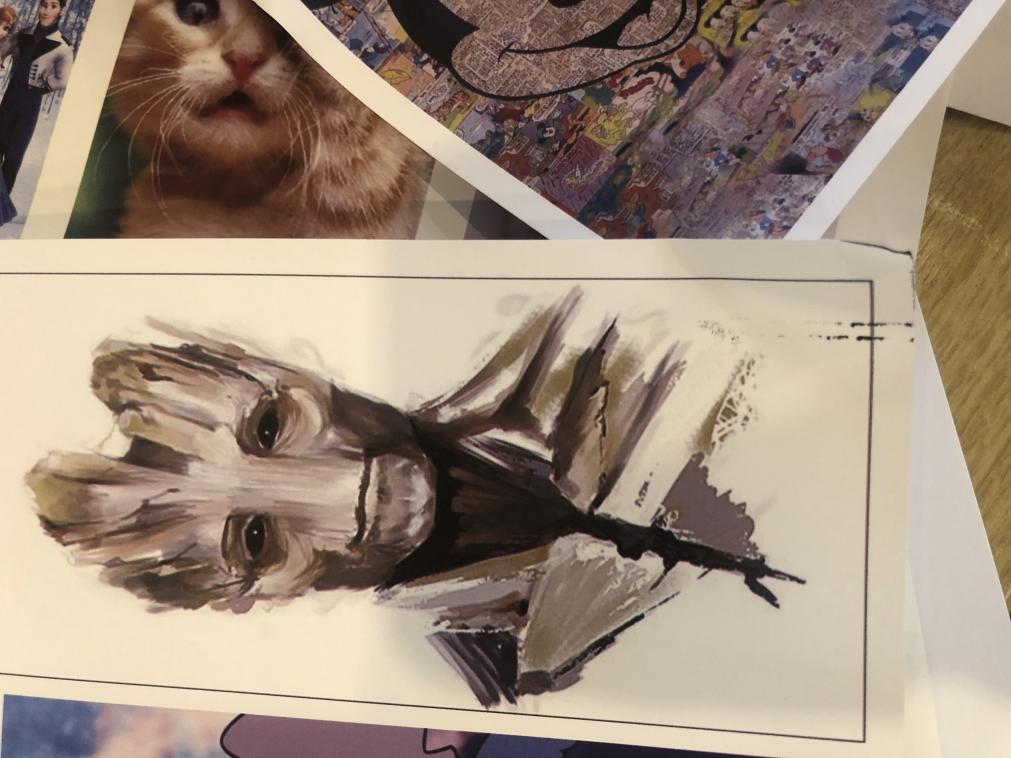

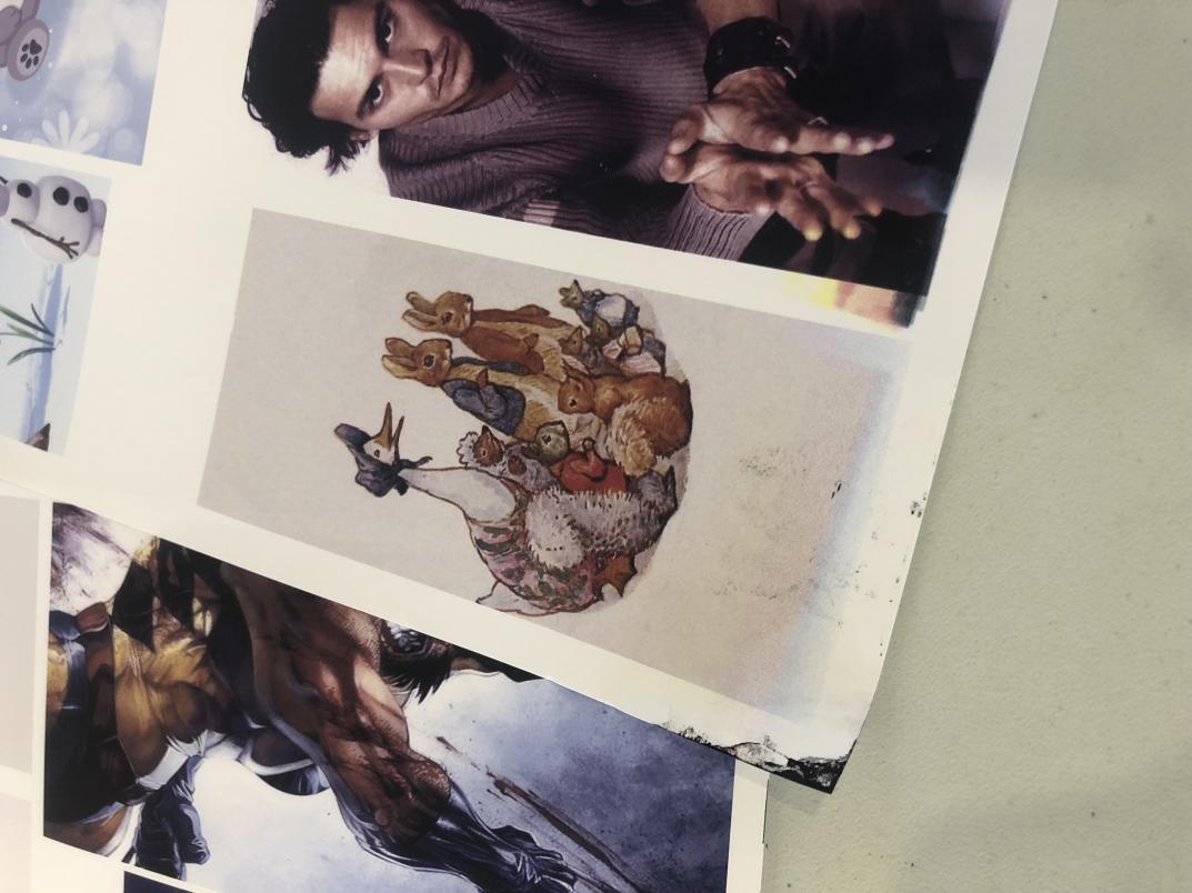

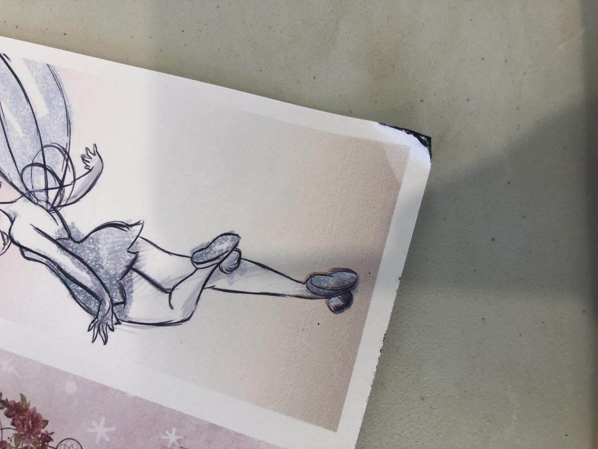

hi guys I'm having some issues with my epson et-2650 which is that black ink marks are appearing on printed pages and there are black ink marks also on the corners/edges on the page.
It looks like there is some kind of ink build up that the page is coming into contact with but I am not sure exactly but hope someone will be able to advise on what I can do to resolve this issue. I have done usual nozzle cleaning but this hasn't fixed the issue.
Please see images showing what is happening when I print.
[ATTACH=CONFIG]6411[/ATTACH][ATTACH=CONFIG]6412[/ATTACH][ATTACH=CONFIG]6413[/ATTACH][ATTACH=CONFIG]6414[/ATTACH]

Are you leaving the paper in the printer between uses?
if you leave it in there the corners tend to curl and that catches the print head and makes it even worse.
Get a fresh sheet and print and you will probably find that the issue goes away.
Re: epson et-2650 black ink marks problem
What paper/inks are you using?
