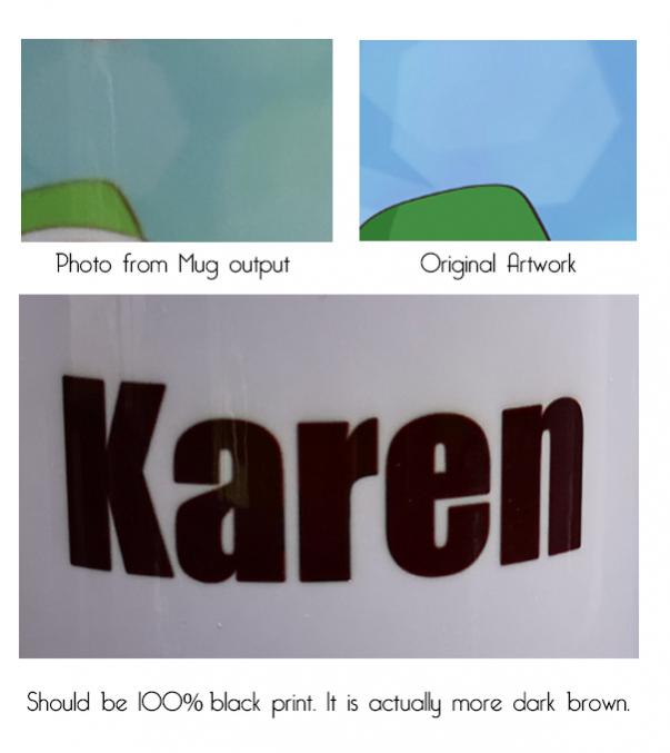

I'm new to dye sublimation printing. I've just purchased an Epson ET-2700 with Sublisplash Ink. I've tried it out on a few mugs (12 now to be exact) and am not happy that the colours on the final product are good enough.
I know it will never match picture printing but I've printed a black logo and it is more brown. I purchased an image specific for mug printing with a light blue background and the end product is light green.

Mugs are being heated at 180degrees for 180 seconds.
I'm attaching images of the issue showing the difference between the colour print and output and the deep black print.
To me, the colours are just off and not correct. I don't think it is the pressing process, I have adjusted different levels of pressure and times. At all times the output is the same. I feel that it is a printing issue.
I was just wondering if there is anyone else using the Epson ET-2700 with Sublisplash ink (and Mac). Are they using it successfully? Or is it a case that equipment cannot print any better?

Re: Epson ET-2700, Sublisplash Colour Issues
The black of the Karen looks over cooked.
180 seconds should be a good starting point form when the press is closed - if your timer doesn't start straight away but waits til the it gets back to 180, then this could be your issue.
In terms of the ICC profile, what software are you printing from, where/how are you using the ICC profile
Have you turned off colour adjustments/management in the print driver?
Yep. Defo overcooked and too much pressure. hence the blurry edges.
