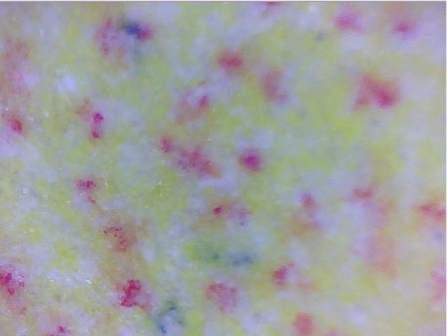

but when printing in notice the color seems to be "off", when using a microscope i see these colors, any idea why magenta & cyan are being printed as well?

thanks for the advice, RGB / CMYK isn't the solution in my quest
I tested a print mug with ICC enabled and overlayed it with a non-ICC ; it seems the ICC is alterign the picture in that way. But in a way that i don't like it; so i think i'll just disable ICC in printing in this case
